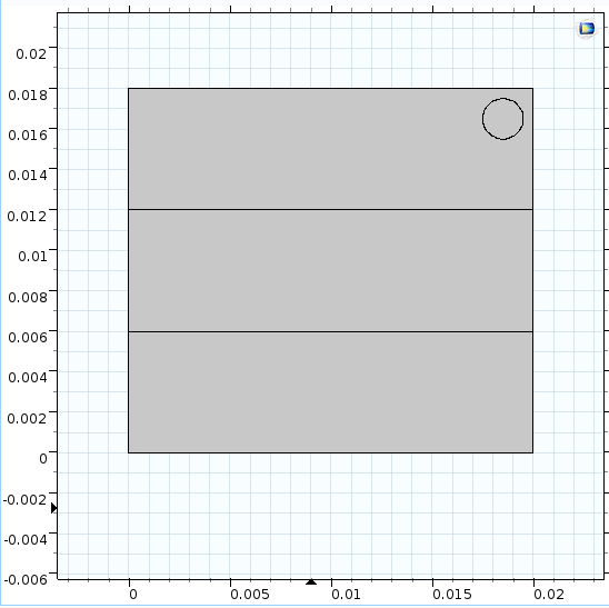

The geometry is really simple (see attached file). It consist of 2 aluminiums sheets and 1 polymer sheet (the center sheet is made of polymer).
My first program was to set a point load on the upper right corner to see déformation. It worked well but it doesn't describe what really happen.
I want to have free rotation at my point load. So i delete a circle from the upper aluminium sheet, i create an aluminium circle with the right dimensions and i use form assembly. I create pairs between the sheet and the circle (both made of aluminium) and i set a load on my circle.
So i use my litle circle to move the rest of the geometry by contact.
As boundary condition, i only put the lowest segment to 0 displacement. (continuity is made between the 3 sheets).
This discribe very well the real case but i have convergence problem. Comsol is not able to run this simple simulation and i was surprised. Because it is 2D simulation with a simple geometry.
I have some results (so i know what i'm doing is right and this is what i really want) but they are useless because the simulation stop before reaching the end of calculation.
