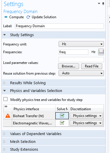

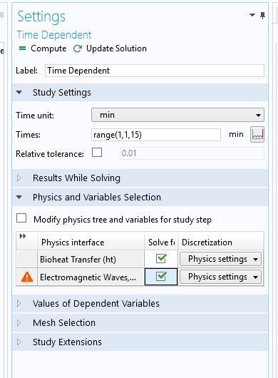

I am using electromagnetic frequency domain (RF heating) and Bio-heat transfer (heat transfer) module in my simulation. I have been using the time dependent study and frequency domain study for it. However, when i choose these studies i can only choose one module for each study - for frequency domain i can only choose electromagnetic frequency module, if i try to click bioheat, a yellow warning sign appears as shown in the attached files. Same for the time dependent study, i can only choose bio heat for it, if i select electromagnetic module a yellow sign appears. Can anyone tell me why is it happening??
i want to calculate the results obtained by both the module (EMW and bioheat) for 15 mins. But i can only choose bioheat in time dependent study. I then came across with another study named "frequency transient" i see that i can choose both the modules in it and it also have option for input the frequency value. Is it the right study for my simulation because i have frequency and 2 modules and i want the results at 15mins? any help would be appreciated.
