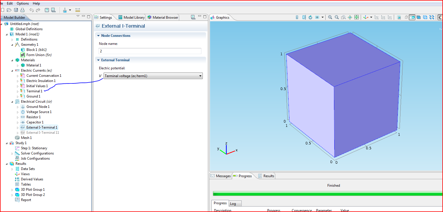

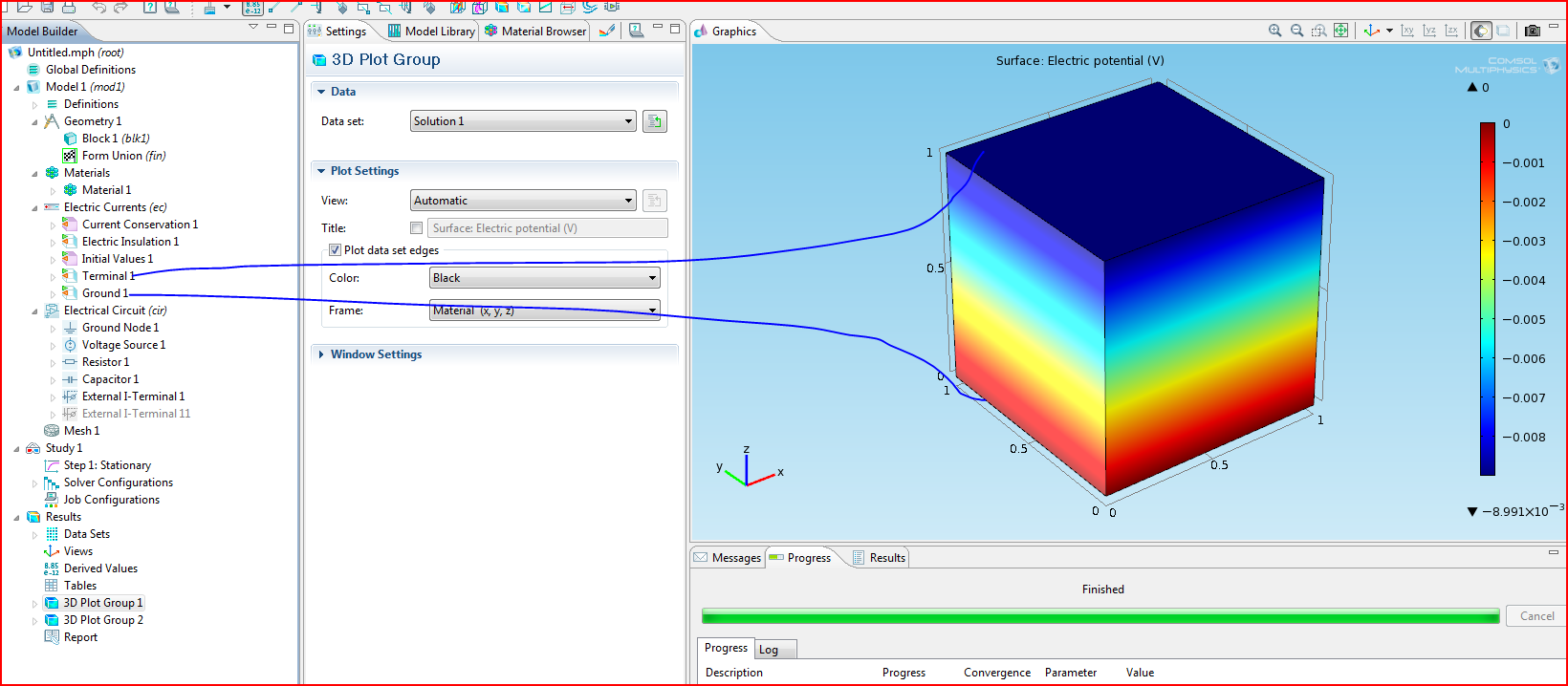

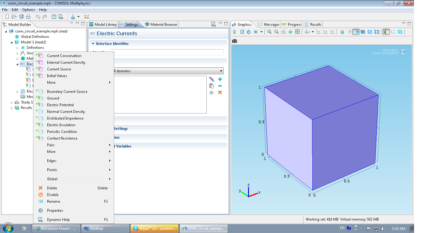

This is quite easy to do but it is somewhat different than in version 3.5a. First you can just save your netlist as a text file (ascii) but with the extension ".cir" e.g. mynetlist.cir.
* Then in COMSOL, create your 3D model using the Electric Currents physics interface (under AC/DC), add also the Electrical Circuits interface (AC/DC).
* Create a block.
* Add a suitable material to the block.
* In the Electric Currents Interface, add a Terminal Feature and set its Terminal type to Circuit and select one face.
* Add Ground feature and select the opposite face.
* Right-click the Electrical Circuits node and select Import Spice Netlist, browse to your .cir file and import.
* Now, you will get the desired feature set under the Electrical Circuits node. There will be two External I-Terminals but as one of them is for the ground end of the finite element model (and circuit) , it will not be needed so disable that one.
* For the remaining External I-Terminal, set the Electric potential to Terminal voltage (ec/term1), i.e. connect it to the Electric currents Terminal.
* Solve the model!
See also the attached screen dumps for guidance.

For those interested, I have taken Magnus's above example with text and pics and put them in a pdf. This way everyone can download one file for all of the info.
