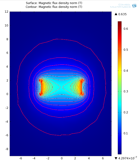

To see the results better right click Results 3D plot Group 1 + add Streamline Set Streamline Positioning to uniform density and 0.1 as separation distance
Then Results 3D lot Group 2 - Slice 1 set Plane Data Planes = 1
To better see the flux lines in a "cut plane do the following:
Results Data Sets + right Click Add "3D cut plane"
Right click Results + add 2D plot Group
Right click Results - 2D Plot group 1 + add Surface plot + Update plot
Note: because of the rather coarse mesh chosen the filed lines might be somewhat staggered.
You might want to zoom in to better see the results
One thing you see clearly the sharp edges of your cylinder are creating singularities (observe how hey worsen with finer mesh) ideally in ACDC your should use rounded corners wherever possible to avoid such singularities, in particular when using the maxwell stress tensor for force calculations

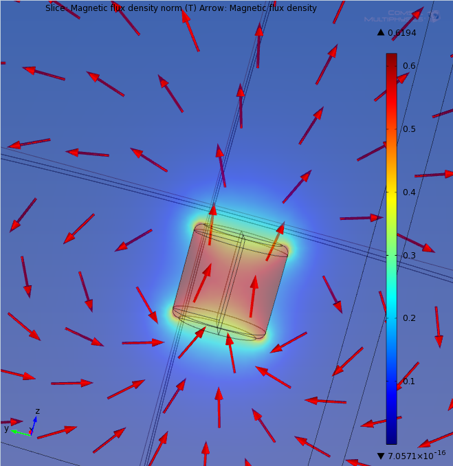

one more thing:
In the example above, you might (to make the view nicer) Select Model 1 Definitions View 1 + right click+ add Hide geometric entities + select the BOUNDARY and the hit the external boundary (1/8 of a sphere) that is between your eye and the magnet + then do an "update" (the "eye" icon on the top border of the GUI)
Then you might turn off the transparency and look inside the air sphere.
If you are interested only what is happening inside the magnet you might remove the full entity/domain" 1 of the air
Note: in 3D geometry COMSOL does not have any 3D fillets (yet, hopefully to come). For that you need to create your cylinder as a revolved 2D workplane with a geometry made from an axial rectangle and you fillet with a given radius the two external corner (not on the axis of symmetry) I let that to you to exercise. The effect on the edge magnetic field is important

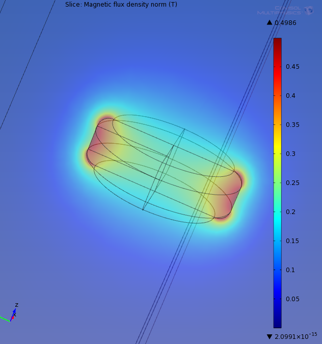

Hi, Ivar. I followed your instructions from your second post but I still think there's something wrong somewhere, or maybe my electromagnetism is a little rusty. I'm attaching the file of my magnet. You'll see the field is stronger at the edges of the magnet when I think it should be stronger everywhere inside the magnet, with the rainbow gradually turning to blue on the outside.
Posted: 1 decade ago 1 mar 2011, 08:47 GMT-5
Indeed, one could believe so.
BUT I suspect that it's your mesh density that is also playing you a game there.
If you select the magnet itself and add a "tet" extremely fine mesh and then solve, you will see that the red region concentrates on the upper and lower edge (as these are singularities) and the external boundary.
Its more apparent if you turn off the smoothing and use a raw No Refinement Resolution for the graph. One should always check the shapes in raw mode, smoothing is nice but you can quickly be fooled by artefact's
If you round the edges off with a fillet radius this effect will reduce somewhat but the .

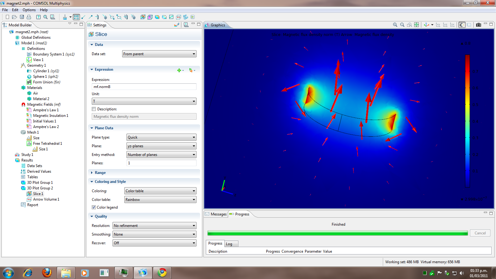

This is what I'm looking at. I followed your instructions and created an "Extremely fine" tetrahedral mesh for the magnet and left Mesh1-->Size at "Fine."
