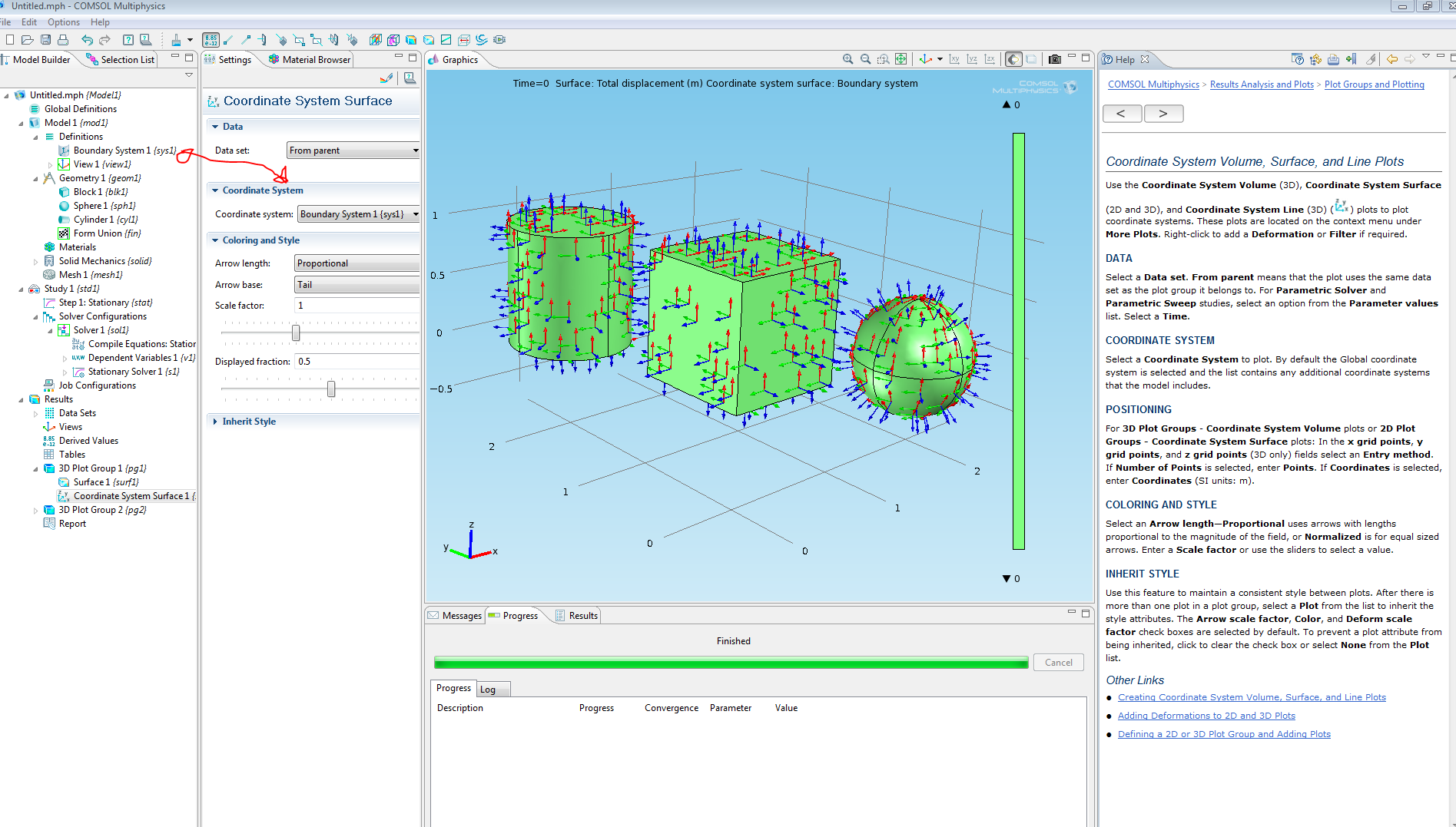

indeed sys2.T11 are part of the transformation matrix of a "user coordinate"system that one can define in V4. The only thing about using them I haven't found the "true" content described in equations, only in "principle", and I'm slightly susceptible, I like formulas that are precise and univoque (thats perhaps a French word, not sure what is the corresponding English / American one ;)
Now I have never trusted that s1, s2 were uniquely normalised, at least there are several warnings about it in the 3.5 doc
In V4 we have the default boundary coordinate system t1, t2, n (in 3.5a too if I remember right) see below
