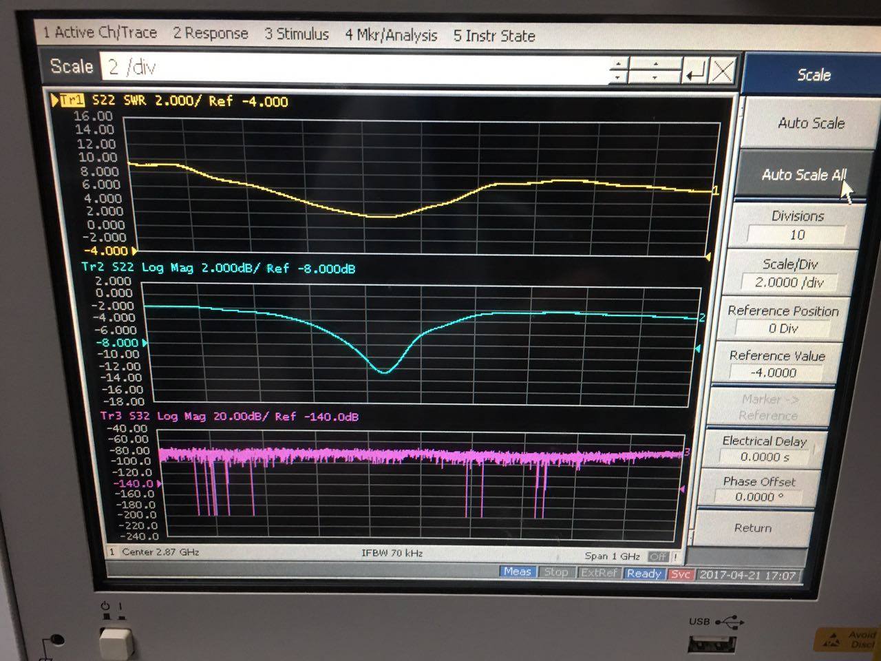

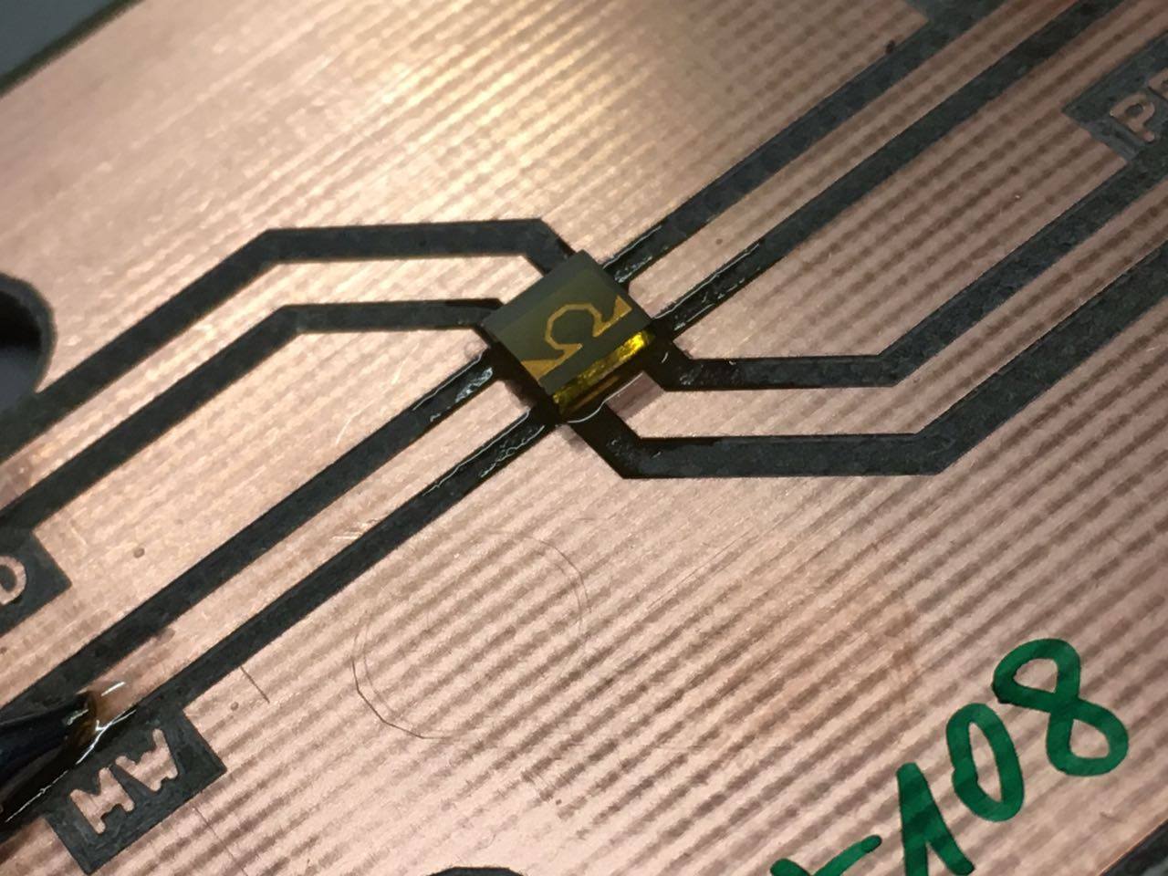

Modeled parameters (S11, S21 VSWR) is far from the reality. I attached files our antenna in real and our measurement microwave analyser (there S22 = S11 (middle), S21 = S32 (bottom), VSWR (upper)). This simulation isnt usefull for our experiment.

We stimulate diamond (that is placed on the omega shape) sample with microwave (sweep 2-4GHz). Input source have 1.8V and its connected to antena by coaxial cable and SMA connectors. On one site there is stimulation by microwave, on second there is 50 ohm terminal.
