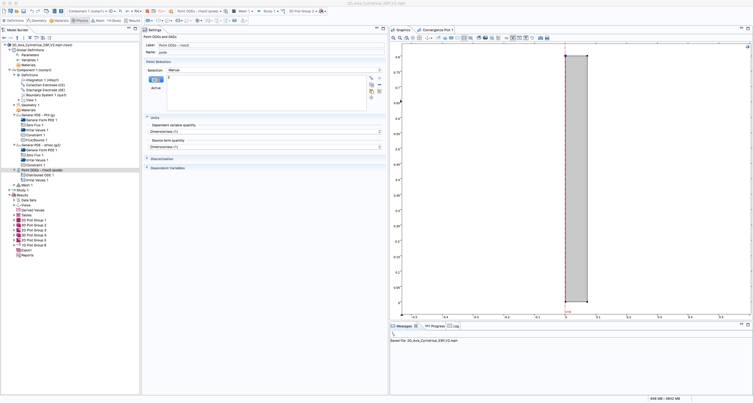

                                                    Thanks for sharing the documents, Dr. Favre.
Originally, I tried to solve the fully coupled equations using weak PDE form for both the electric potential and space charge density. For the space charge density weak PDE, I used a weak contribution along with an auxiliary variable as the Lagrange Multiplier.  Though, I was able to obtain converged solution. The solution is nothing like the analytical solution for a typical cylindrical plasma generator.
Now, I am implementing the method used in your COMSOL paper with three equations. However, I still cannot obtain the correct solution. I am solving an 1-D Axisymmetric problem by using a line as the geometry with two point boundaries. I have tried to match the settings you used in your 3D model. Any suggestions?
Thanks.

                                                    Thanks Eric. I have my technical problem fixed.
The method you proposed by splitting rho into rho0 + drho works really well. I assumed the integration operator plus the point ODE (pode) serves as a way to impose a integral constraint on a point on the emitting electrode (Am I right?)
However, for me so far, the method works only for geometry with two concentric electrodes (2D). I have been trying to implement this new method to 1D Axis and 2D Axis, but no converging results yet.
Thanks for the help.

                                16 set 2016, 03:16 GMT-4
                                                    Hello Eric,
1D cartesian should not be different from 2D cartesian.
In 1D or 2D axisymetric case, there is this subtility in the case you use a mathematical PDE : those mathematical equations should be slightly adjusted to the coordinate system in use.
The model example "Spherically symmetric Transport" (
www.comsol.fr/model/spherically-symmetric-transport-8481) demonstrates how to multiply some coefficients of the PDE by r^2 in 1D spherical coordinate. The source term of Neumann-like boundary conditions should be adjusted as well.
In axisymmetric case (r in 1D or (r,z) in 2D ), the same approach leads to multiplication by r.
I hope this corresponds to your case.

                                                    Hi Eric,
I am trying to model the effect of dust layer on space charge density (rhoc) and electric potential (PHI). Therefore, I am modifying the boundary condition on the collection electrode to become a non-linear one.
Old BC:
PHI = 0
New BC:
PHI = - constant * rhoc * PHIr, where rhoc = rho0p + drhoc
Both the constant Newton and automatic Newton solvers lead to singular matrix. The double dogleg seems to be converging after 1000 iterations, but I am not sure if this is the correct way to pursue convergence.
I would like to know if implementing such a non-linear BC is possible?
Thanks in advance.
                            Hi Eric,
Old BC:
PHI = 0
New BC:
Thanks in advance.

                                                    Hi Eric,
convergence should be straightforward. If not, this is likely that the problem is not well posed. The information you give is not detailed enough to locate the possible source of the problem. I encourage you to contact the technical support with more details for more advanced assistance.
Good luck,
Eric Favre
COMSOL France
                            Hi Eric,
Good luck,
Eric Favre
COMSOL France
