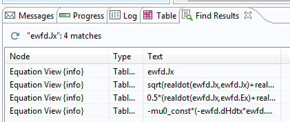

The fastest way of finding a variable is to search for it by Ctrl-F. In the results from the search you can double-click any row, and get automatically redirected to the corresponding reference in Equation View.
See the attached screenshots.
There is no comprehensive list of all variables. It would fill books. The variables which are visible and accessible to you as a user of COMSOL Multiphysics is of the same order of magnitude as the number of variables defined under the hood by the programmer of a (or maybe several?) traditional FE program. The order of magnitude is probably 10^5.
There is a small number of variables which, for various reasons, are not possible to show in Equation View. If you have a question about such a variable, you can send it so support.
Henrik
Hi, The fastest way of finding a variable is to search for it by Ctrl-F. In the results from the search you can double-click any row, and get automatically redirected to the corresponding reference in Equation View. See the attached screenshots. There is no comprehensive list of all variables. It would fill books. The variables which are visible and accessible to you as a user of COMSOL Multiphysics is of the same order of magnitude as the number of variables defined under the hood by the programmer of a (or maybe several?) traditional FE program. The order of magnitude is probably 10^5. There is a small number of variables which, for various reasons, are not possible to show in Equation View. If you have a question about such a variable, you can send it so support. Regards, Henrik

Thank you very much! For future reference, I was able to find the required variable definitions in the "Equation view" node of the "Wave equation" node (not the Physics interface node)
