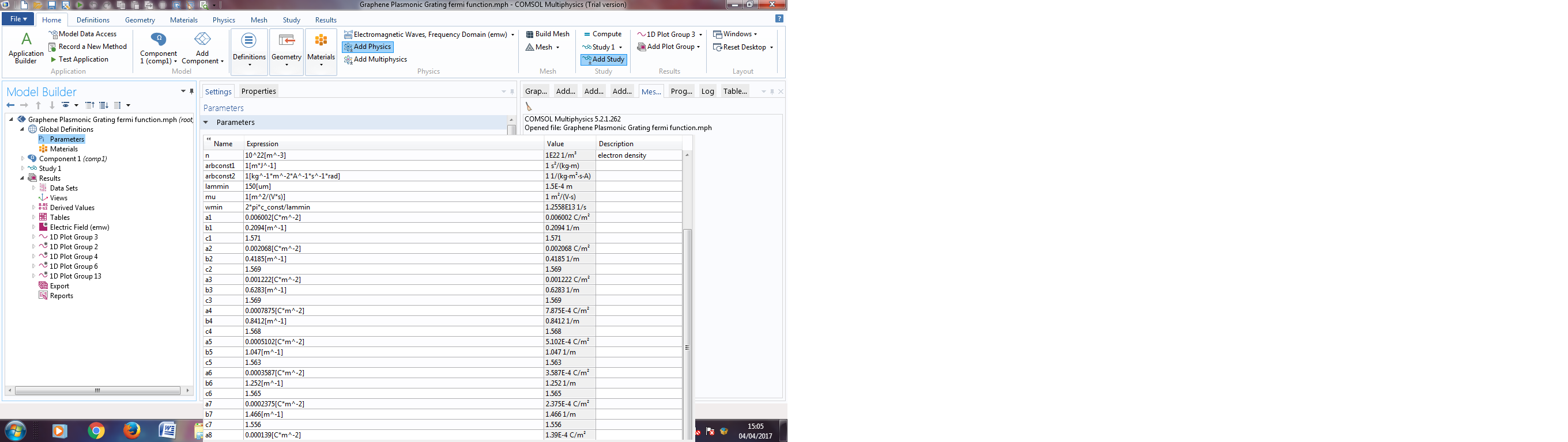

Hi! I'm using comsol 5.2a. I've found a function for results from another comsol file, and I'd like to use that function to describe it in another file in order to save file size and computational time.

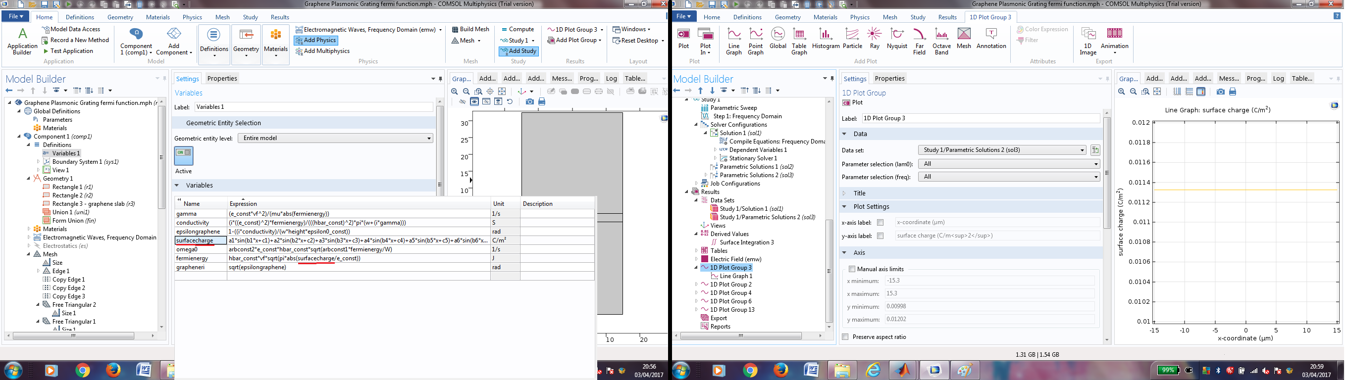

I've defined it as a variable with lots of parameters associated, as shown in the screenshot. I went to check that it was working correctly but unfortunately comsol believes the function is actually a constant - the value of the function at it's maximum (x=0). What's going on here?

Hi Mohammad, thanks for the response. I've screencapped the relevent part of the parameters list for you in parameters.png. The parameters are non-zero. The a parameters have units of surface charge density, the b parameters have inverse spatial units so to cancel b*x to be unitless, which is compatible with the c parameters which are also unitless.
I also changed the variable to "surfacechargerrr" with the plot also changed, just in case comsol reserves the string "surfacecharge", but it still displays the same thing.

Hi Mohammad, thanks for the response. I've screencapped the relevent part of the parameters list for you in parameters.png. The parameters are non-zero. The a parameters have units of surface charge density, the b parameters have inverse spatial units so to cancel b*x to be unitless, which is compatible with the c parameters which are also unitless. I also changed the variable to "surfacechargerrr" with the plot also changed, just in case comsol reserves the string "surfacecharge", but it still displays the same thing. I have previously tried to plot another constant called omega0 which can be seen in straightline.png, but this depends on fermienergy too so that isn't too surprising. I initially thought that perhaps it had to do with the order the variables are listed in, but for some reason the ability to move the order has been greyed out for me. I can manually delete the ones above it and input them in the correct order again, but after saving and reopening, they are back in the wrong order. It doesn't seem to matter in this case though, as comsol seems to recognize all the variables regardless of order. Would you like me to send you the file? I'd rather not send it in public, as it is private research material, but if you'd like to make a temporary email address (temp-mail.org, mytemp.email etc) I can send it over.

I'd be happy to help you. But, no need to send your file. Just look at the terms in the sine function. They are not in the same order of magnitude. Therefore, the sine functions are almost constant and do not vary with variable x.
For instance, lets look at sin(b1x+c1):
b1x=0.2094[1/m]*15*1e-6[m]=0.00000314
while c1=1.571
Thus:
sin(b1x+c1)~sin(c1)
sin(b2x+c2)~sin(c2)
sin(b3x+c3)~sin(c3)
sin(b4x+c4)~sin(c4)
Try to change the units of b1, b2, b3, ... to micrometers and see the difference.

Perfect, that fixed it. I changed the units from micrometres to metres and b*x became comparable to c. Matlab was able to render the tiny variation but Comsol was not so I guess there is a decimal difference there or something.
