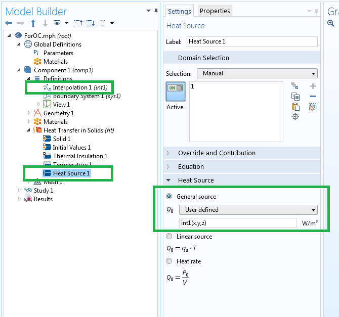

Posted: 9 years ago 31 mar 2017, 08:27 GMT-4
See the attached screenshot.
PS: I encourage you to work through the Introduction to COMSOL Multiphysics manual (Accessed through File > Help > Documentation). It will save you a lot of time compared to trying to figure things out by yourself. The Applications Libraries are also full of tutorials with step-by-step instruction that you can use for self teaching.
See the attached screenshot. Best, Jeff PS: I encourage you to work through the Introduction to COMSOL Multiphysics manual (Accessed through File > Help > Documentation). It will save you a lot of time compared to trying to figure things out by yourself. The Applications Libraries are also full of tutorials with step-by-step instruction that you can use for self teaching.
Posted: 9 years ago 31 mar 2017, 13:41 GMT-4
Hello Jeff.
Thanks for your help. I was missing the units. In Heat Source it is int1 (x [1 / cm], and [1 / cm], z [1 / cm]). This was my mistake. But thanks to you, you were a great help.
Cordially
Oriana
Hello Jeff. Thanks for your help. I was missing the units. In Heat Source it is int1 (x [1 / cm], and [1 / cm], z [1 / cm]). This was my mistake. But thanks to you, you were a great help. Cordially Oriana
