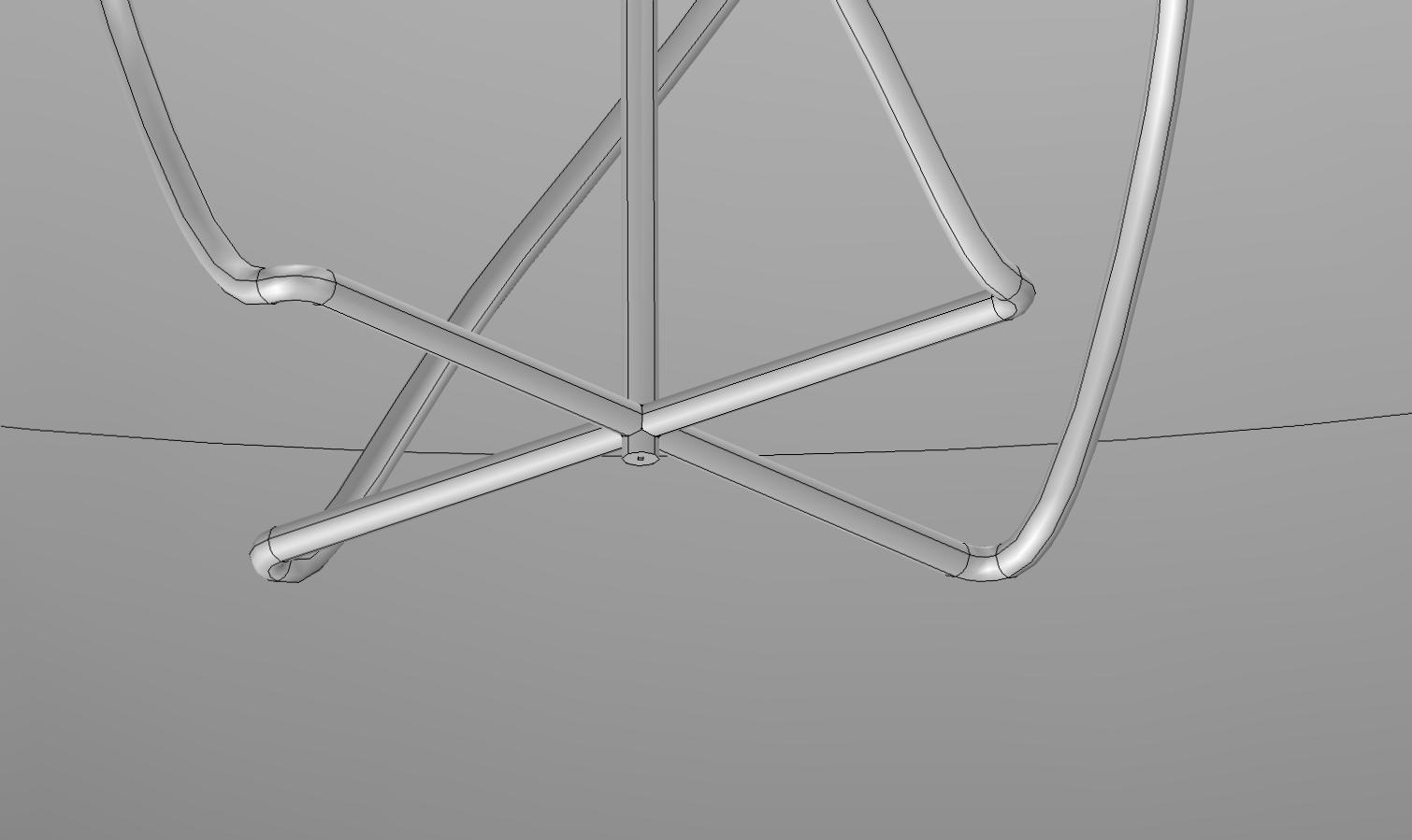

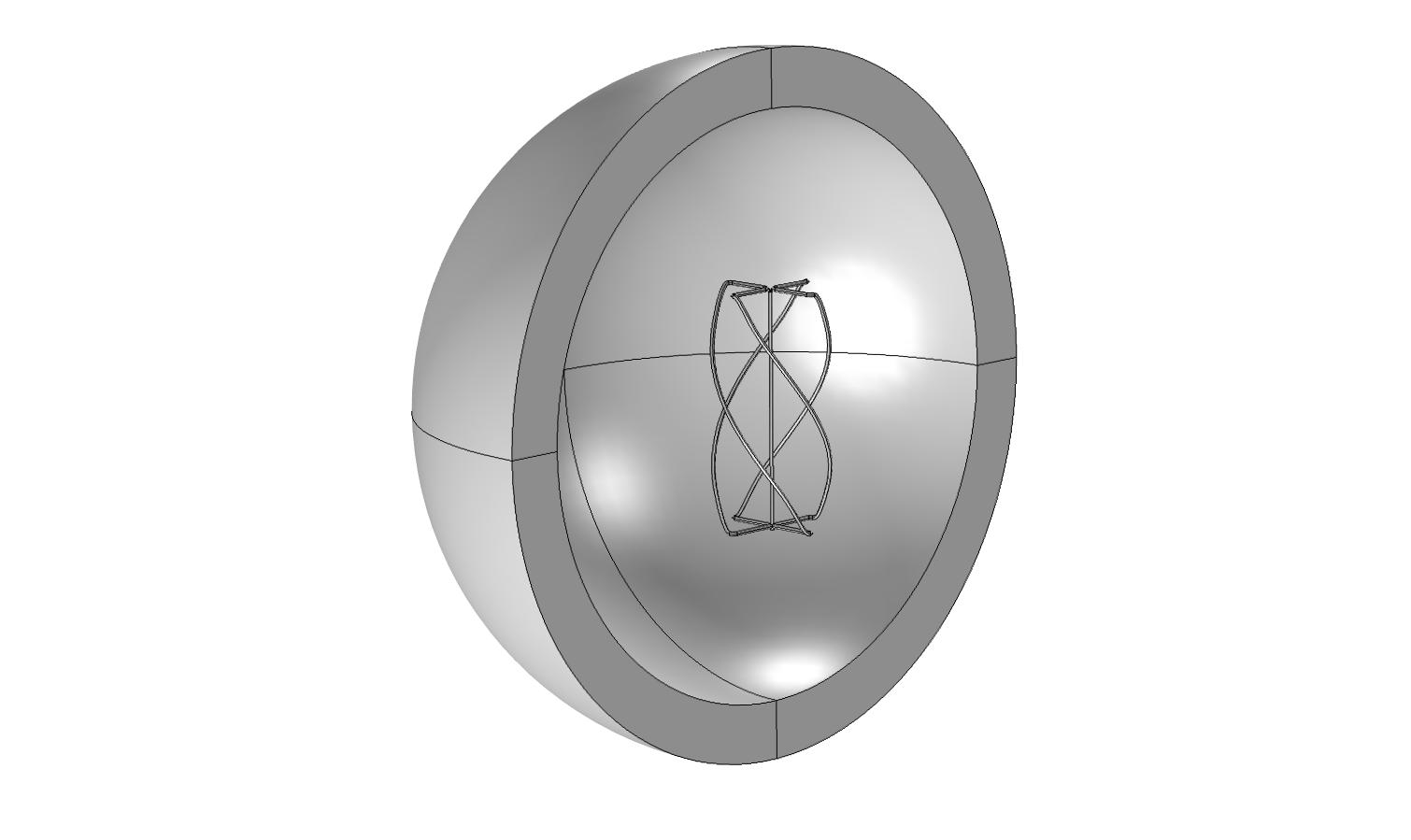

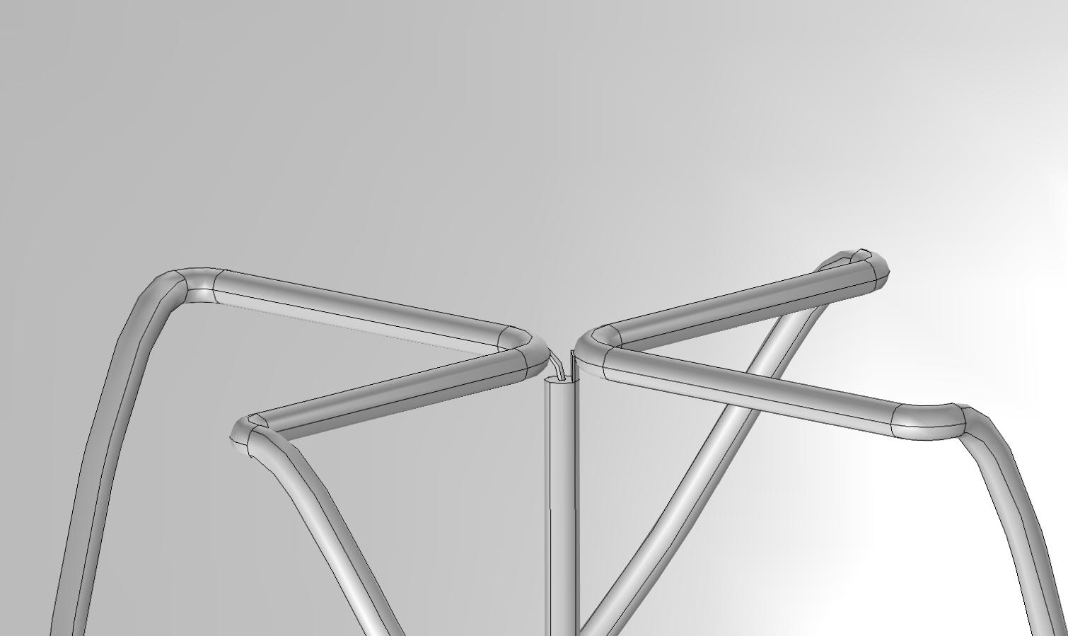

I have built a model in comsol as seen in the picture. I've put the arms, inner conductor and the outer conductor as "Perfect electric conductor" boundary. in the bottom of the center coax cable i've put the boundary between the inner and outer conductor as a "lumped port". I have a far field boundary as seen in the pictures. The outer boundary of the Far field sphere is put to a "Scattering boundary condition"
All domains ar set to air and the the arms and conductors are in copper, the dielectric in the coax is PTFE with epsilon_r = 2.1.
The mesh is set to minimum wavelength of 0.2*wavelength.
When I simulate it, it never seem to converge and ran for a hour on one freq. Thats when i gave up and started thinking that I have done something wrong. I've only done RF simulations for a week and will take any help/lesson I can get and will appreciate it immensely.

Comsol mostly chooses an iterative solver as default in RF models. Try a direct solver if you have enough memory.
If you can upload the model we can have a closer look.

Sebastian,
a quick look into your model revealed that some metallic boundaries around the feed into the helices are not properly assigned. You may want to check that.
