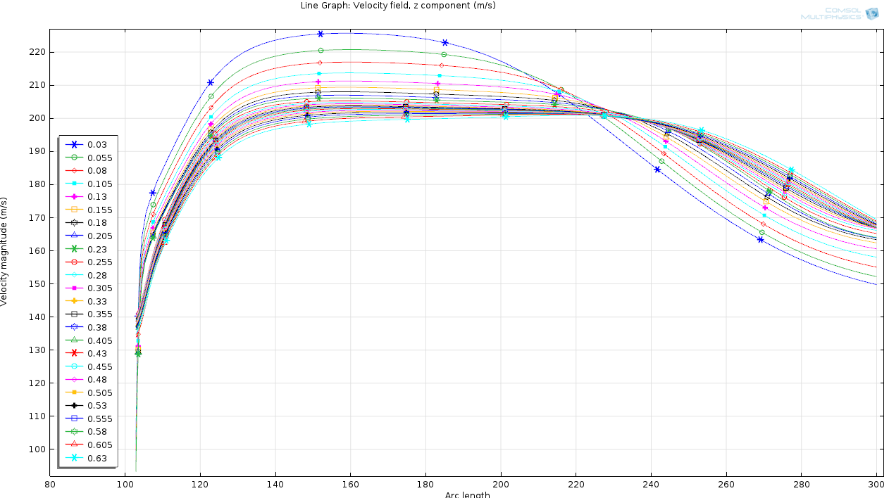

I want to display the legends on the plot, but It seems that the Legends are always in the right-up corner of a plot, and sometimes the Legends will overlap part of the data curves. Can the position of the Legends in plot be moved? (I use v4.0)

I'm not sure in 4.0, but in 4.1, in the main plot node you can select one of the 4 corners of the plot for the legend "box"

Does anybody knows if there is a way to have a few more options for the legend position? I.e. right center? My plot has data in all four corners.

not from my knowledge, I'm also miss a middle position, for many of my plots, at least in the height direction ;)

I know it is an old post - but I found a solution/workaround.
Simply make the scale on the X-axis longer. Then the legend will fit and it will not cover any of the data.
