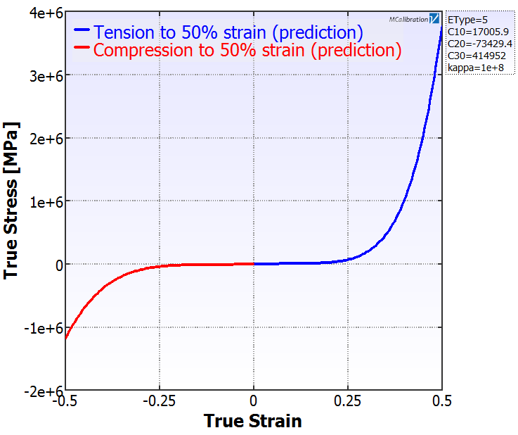

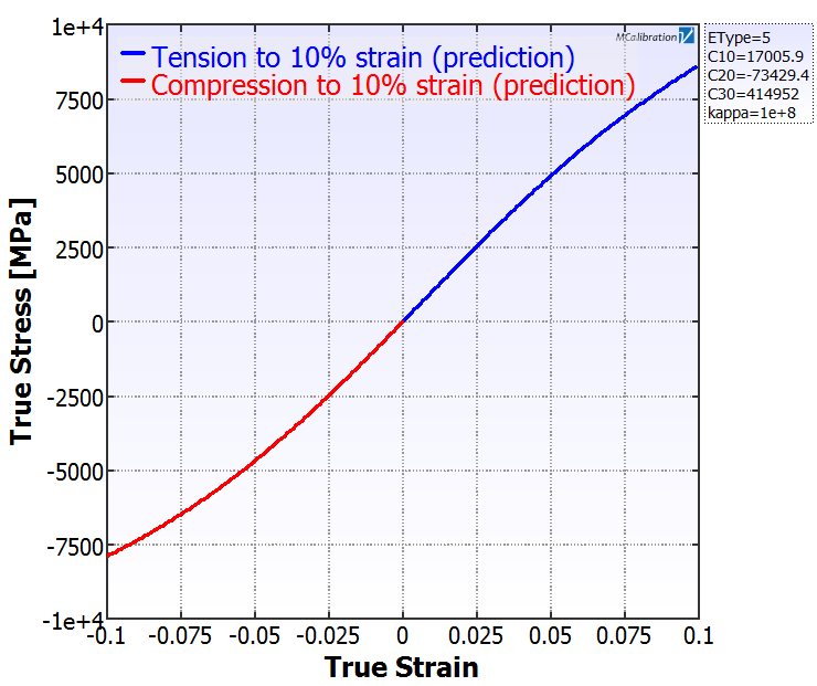

Here are figures showing the stress-strain behavior up to 10% logarithmic/true strain and up to 50% logarithmic/true strain.
