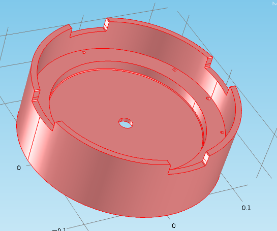

I'm in 3D - my object is something like a cylinder (a bit more complicated, but basically a flattish cylindrical shape, see attached .png). the bottom of the object is heated, while the rest is exposed to the convective cooling. I'm afraid I don't know how to translate your answer to my problem - could you give me a hint?

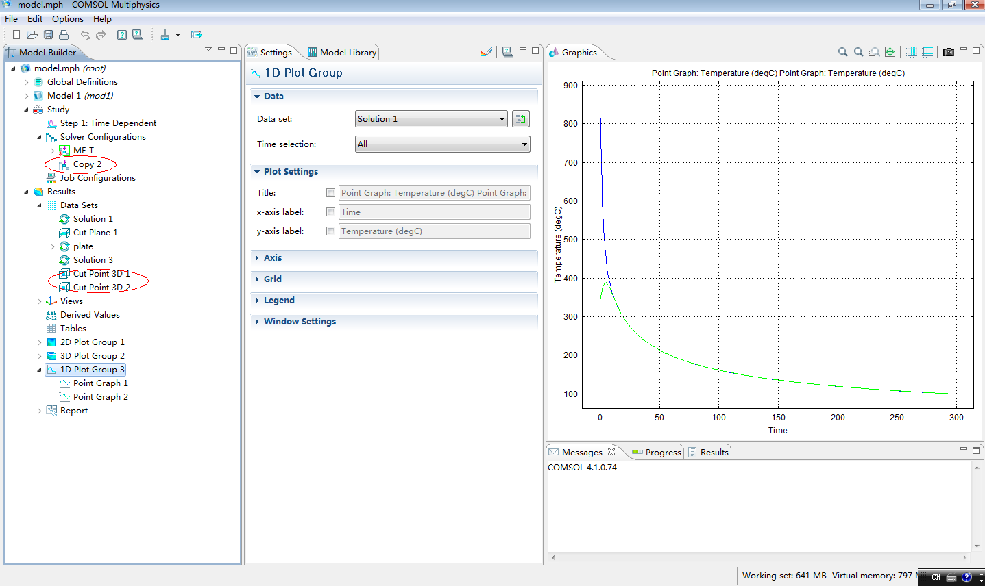

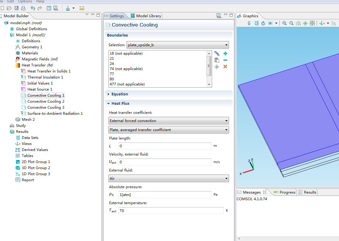

Posted: 1 decade ago 25 dic 2012, 11:32 CET
i know some about the characteric length of surface:area/perimeter,but use it, i still cannot get the result i needed.
there are some pictures about my question, in the picture copy2 is the heating result as the initial value of cooling process ,two 3D cut points express one upper and another down surface,
for a flat plate model,the plate length and characteric length is same? and my way to express the characteric length is rigth or wrong?
so could you give me some advice??
thank you
i know some about the characteric length of surface:area/perimeter,but use it, i still cannot get the result i needed. there are some pictures about my question, in the picture copy2 is the heating result as the initial value of cooling process ,two 3D cut points express one upper and another down surface, for a flat plate model,the plate length and characteric length is same? and my way to express the characteric length is rigth or wrong? so could you give me some advice?? thank you
