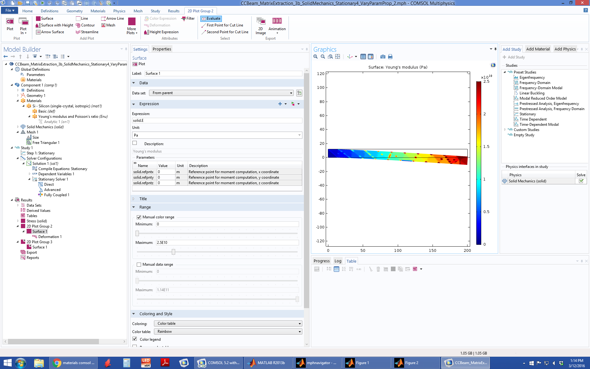

Posted: 10 years ago 12 mar 2016, 16:19 GMT-5
Walter,
Thanks for the great explanation. Is there a way to give COMSOL tabulated x,y,z coordinates with the property E(x,y,z) at each point and have COMSOL interpolate the material property between these points? I am using a discontinuous function but always get errors on the boundaries due to computer rounding errors. See picture. (Also, I realize now that I should do a linear interpolation across a single element rather than keep it's properties constant. Don't mind that.).
Walter, Thanks for the great explanation. Is there a way to give COMSOL tabulated x,y,z coordinates with the property E(x,y,z) at each point and have COMSOL interpolate the material property between these points? I am using a discontinuous function but always get errors on the boundaries due to computer rounding errors. See picture. (Also, I realize now that I should do a linear interpolation across a single element rather than keep it's properties constant. Don't mind that.).
Walter Frei COMSOL Employee
Posted: 10 years ago 14 mar 2016, 08:55 GMT-4
Dear Dustin,
Follow this: www.comsol.com/blogs/using-point-cloud-data-in-your-comsol-model/ and use the Nearest Neighbor interpolation and Nearest Function extrapolation.
If you are still having difficulties, contact your COMSOL Support Team.
