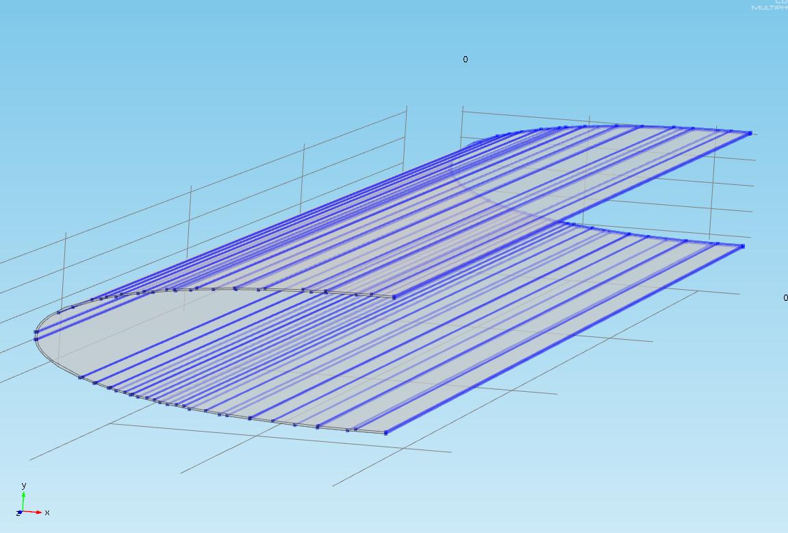

Posted: 1 decade ago 12 giu 2014, 22:31 CEST
Hello
I am trying to mesh the geometry as shown in the attachment. It has a thickness of about 0.05inches.
I tried to mesh using most of the mesh options available in 4.3a version, but still the error persists.
May I please know how to work on the problem?
Hello I am trying to mesh the geometry as shown in the attachment. It has a thickness of about 0.05inches. I tried to mesh using most of the mesh options available in 4.3a version, but still the error persists. May I please know how to work on the problem?
Posted: 1 decade ago 11 mar 2015, 17:30 CET
I am aware this reply is late but if anyone else comes to this thread for advice on meshing,
I would have used a free triangular mesh on the arc then swept through the rest of the domain with a distribution and finally used a converted to change the squares created by the swept mesh into triangles.
Andy
