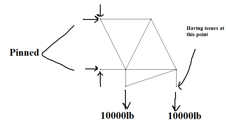

I am brand new to COMSOL. I am following a guide for setting up a truss structure provided by my professor. I have the truss created, however I am getting an error upon solving it at one of the points where there exists a point load. This truss is holding up a basket, attached to where the point loads are. We are only to model it as I have shown in the attached file. Any help as to how I can eliminate this error?
