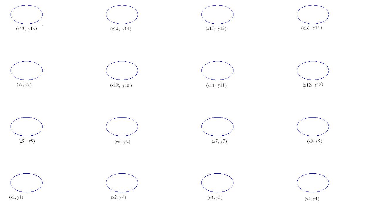

I made a MATLAB program which is plotting circles of same radius at different centre points. The centre points are placed to circles using for loops. (The schematic of pattern is attached in the file)
Now I want to convert this MATLAB code to Livelink to MATLAB format so that I can open the same geometry in COMSOL. My requirement follows approx same methodology which is given at page number 40-41 manual of Livelink to MATLAB user guide to plot circles at different centre points. The methodology says that the first circle plotted with given position and when then the loop rewind, the new values of centre point is allocated and the new circle will be plotted. The first circle remain on its position (Unfortunately I am unable to execute it)
