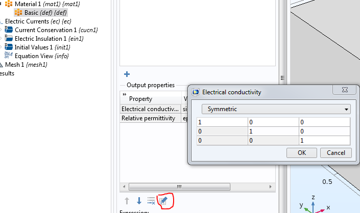

I have a simulation where I have an anisotropic electrical conductivity for two different materials.
I was wondering how I go about entering the material properties.
For example, the conductivity is a 3x3 tensor, but I don't know the syntax/where to enter the component values.
For a single material I just enter the values from the equation view and it gives me a matrix where I type in the value in each location. But with two materials, I'm assuming I have to enter the 3x3 tensor in the material properties node. I only know how to type in a scalar.
Should I type it something like {s11,s12,13,s21,s22,s23,s31,s32,s33} where s11,s12,etc is the values I have? Or do I have to click on something to get the matrix view that I can fill in the components of?
