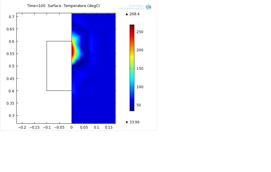

Please find attached an image(RF.jpeg) result of the first part which is related to Microwaves heating(RF Module). After the colored distribution of temperature, I want to start my Heat transfer module using the temperature distribution obtained from RF module and proceed further in the same model.
Can you please give some educated ideas of doing it, if you want to see the model files, I can make the files and post them to you as well?

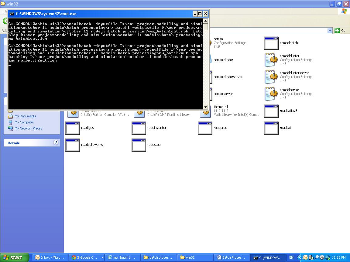

For the batch processing, I have made the correction in the batch file but still did not get any thing as I am confused about the process. I will write in detail what I did, please correct me if I am wrong?
I have two comsol files which I want comsol to run one after the other by using batch processing. I have stored them in D drive. I wrote the lines mentioned in the attached word document and stored it as batch.bat in the C:\COMSOL40a\bin\win32 directory.
Then I run this bat file, it opens DOS window with two lines appearing on the screen one after the other as shown in the figure and vanishes after a moment. Then I checked my folde of D drive where I have stored my comsol files but there are no out put files available. Should I make two COMSOL files as output as well? If yes, should they be empty?
Please clarify the whole procedure.
I will be obliged to you.
Thanks and regards,

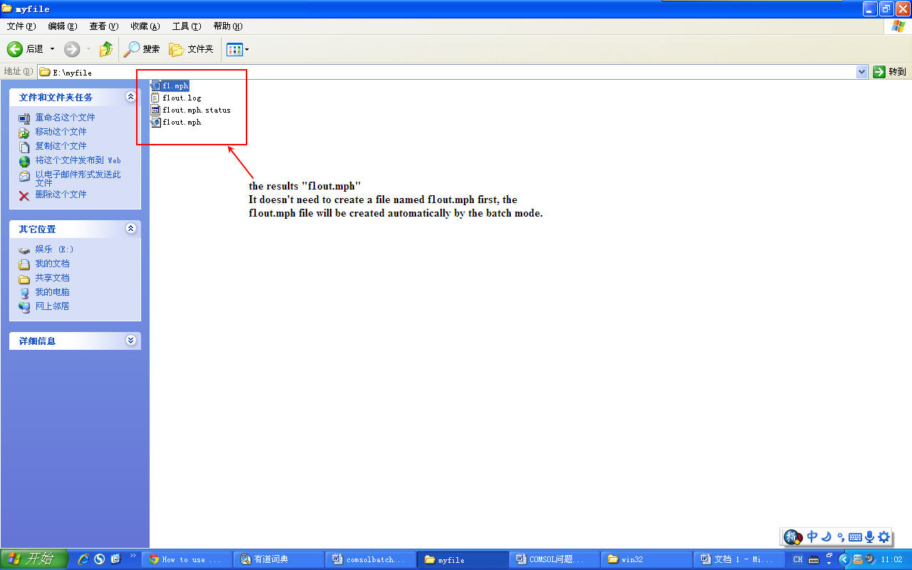

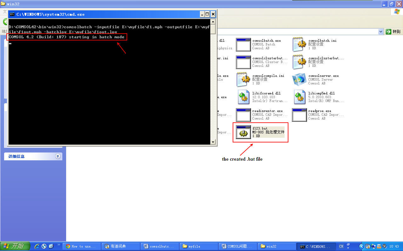

I don’t know why your batch mode didn’t work. I have tried this function again, and it worked, you can see the attached “picture1”. Now I will write out the steps again (just as an example).
1. create an .mph file, and save this file as E: \myfile\f1.mph
2. open the notepad, that is Start-all program-attachment-notpad, and write the below command:
comsolbatch -inputfile E:\myfile\f1.mph -outputfile E:\myfile\f1out.mph -batchlog E:\myfile\f1out.log
Choose the file types as all files, and save this file as D: \COMSOL42\bin\win32\f123.bat (see attached picture1).
3. double click the file f123.bat to run (see the attached picture1)
4. check the results (see attached picture2)
By the way, for your failure running, I’m not sure whether it has something to do with the windows operation system or the Comsol version. My operation system is windows xp, and the Comsol version is 4.2.

Yes your file is working but I do not know why it is not working in my case? Please have a look on the attached word document and rectify me if I am wrong. I am copying and pasting this text into the Notepad file and saving this text document as batch_result.bat in the COMSOL directory win32 folder as you mentioned.
Please find attached my model file as well for your reference and check why heat is not propagating deep into the fluid?
Thanking in anticipation.

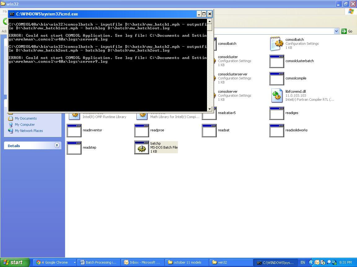

I tried to do the same bu putting the path of file in quotes but when I run the batch file after saving it, it just appeared momentarily and vanished. If I finish the quotes, it stays there for some time showing the following message but nothing starts and it closes after some time(seconds). Please see the attached image for the clear view of what it shows?
Also please find attached the word file, I copied the text in Notepad file and saved it as batch_result.bat in COMSOL directory but did not receive any out put in response on running it except monetary show up.
Can you please suggest some thing else?
I can give two suggestions, you can try them.
1. Shorten the storing directory of the .mph file, like what I did, maybe it's the problem of the space between the words.
2. I cannot see the .bat file on your screen shot, are you sure you have saved the .bat file where it should be? On my screen shot attached last post, you can see the .bat file which is highlighted by the red arrow.

According to your suggestion, I tried to proceed further by saving the .mph locations where there were no spaces in the names of the folders in path. I got cleared from that error but trapped in another error, please look at the attached image. You can also see the .bat file created in the path of COMSOL in C drive.
Can you please give some clues about thus error?
Thanks in advance.

If you have two .mph files (f1.mph, f2.mph) stored under E:\myfolder
you can do like this:
open the notepad, and input the command lines below:
path=%path%;C:\Program Files\COMSOL\COMSOL52\Multiphysics\bin\win64
comsolbatch -inputfile E:\myfolder\f1.mph -outputfile E:\myfolder\f1out.mph -batchlog E:\myfolder\f1out.log
comsolbatch -inputfile E:\myfolder\f2.mph -outputfile E:\myfolder\f2out.mph -batchlog E:\myfolder\f2out.log
store the file as f123.bat (for example)
If you include the path command as the first line of the batch file, you don't need to put the batch file actually in the COMSOL installation directory.
You could put the batch file on your desktop and when you double click on the .bat file, the batch file will run as you expect.

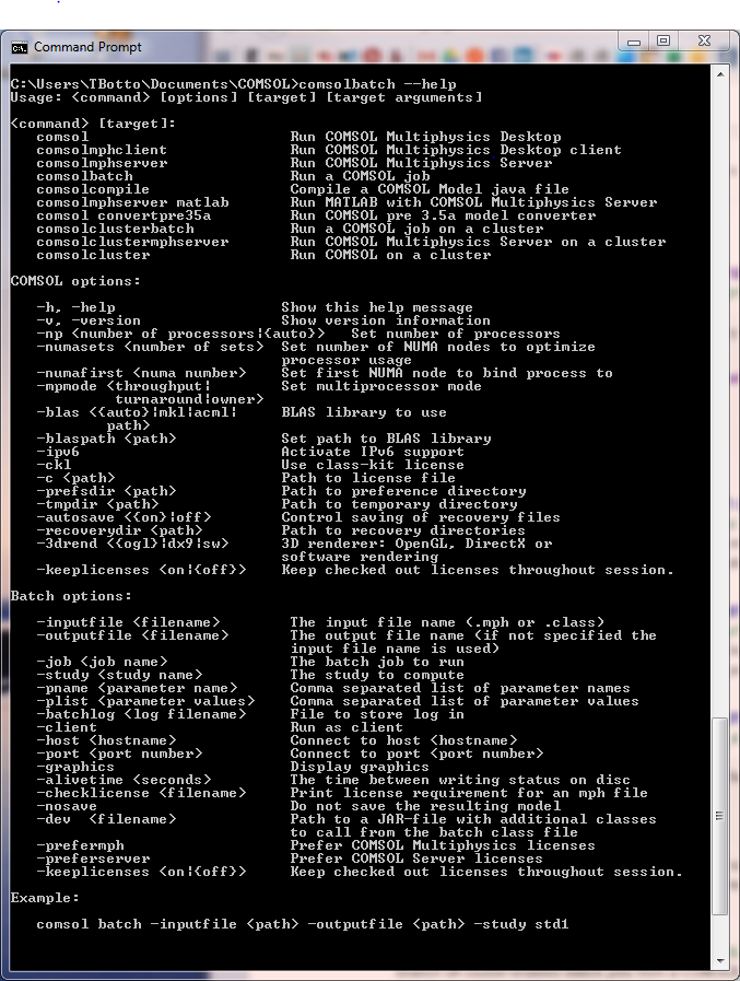

www.comsol.com/community/forums/general/thread/31918/
as well as running comsolbatch --help from the command line (see screenshot)
