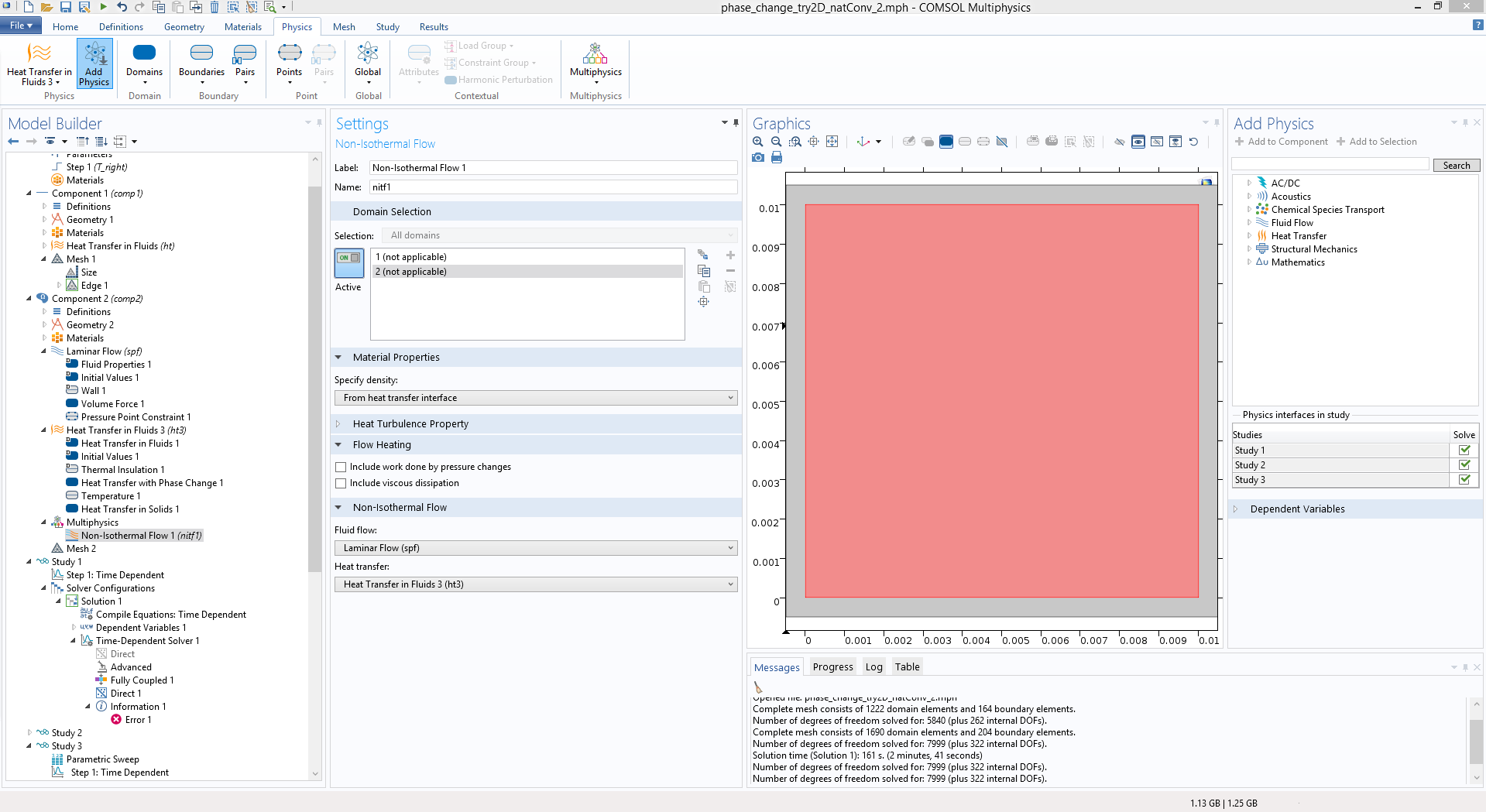

I have the following selected
where 1 is the outside solid and 2 is the inside fluid
Heat transfer in Fluids 3 (ht3) : [1 & 2]
Heat transfer in Fluids 1 : [1 & 2 (both overridden)]
Heat transfer with Phase Change 1 : [2]
Heat Transfer in Solids 1 : [1]
in the Laminar Flow domain only domain 2 is selected

I still have not been able to figure this out...
the domains which are currently selected seem to make sense, is there a mistake there?
where else could I look to see why I am unable to select the fluid in the Non isothermal flow component?

so it seems the only way I can select the fluid domain in the 'non isothermal flow' component is to disable 'Heat transfer with Phase change' in 'heat transfer in fluids'
Are these two modules not able to work together? If so, how do I manually couple the heat and fluid flow?

You do not need separate solid and liquid node in heat transfer module when you use phase change material node. Depending on initial temperature value of the domain, it will behave like solid or liquid. In laminar flow physics node include both domains. See the attached model I created based on your problem description. Hope it will help you.

the ability to combine Nonisothermal Flow multiphysics node with Phase Change Material feature has been introduced in COMSOL version 5.2a. We recommend to update to this version to benefit from this new capability. For further information please contact the COMSOL support team:
