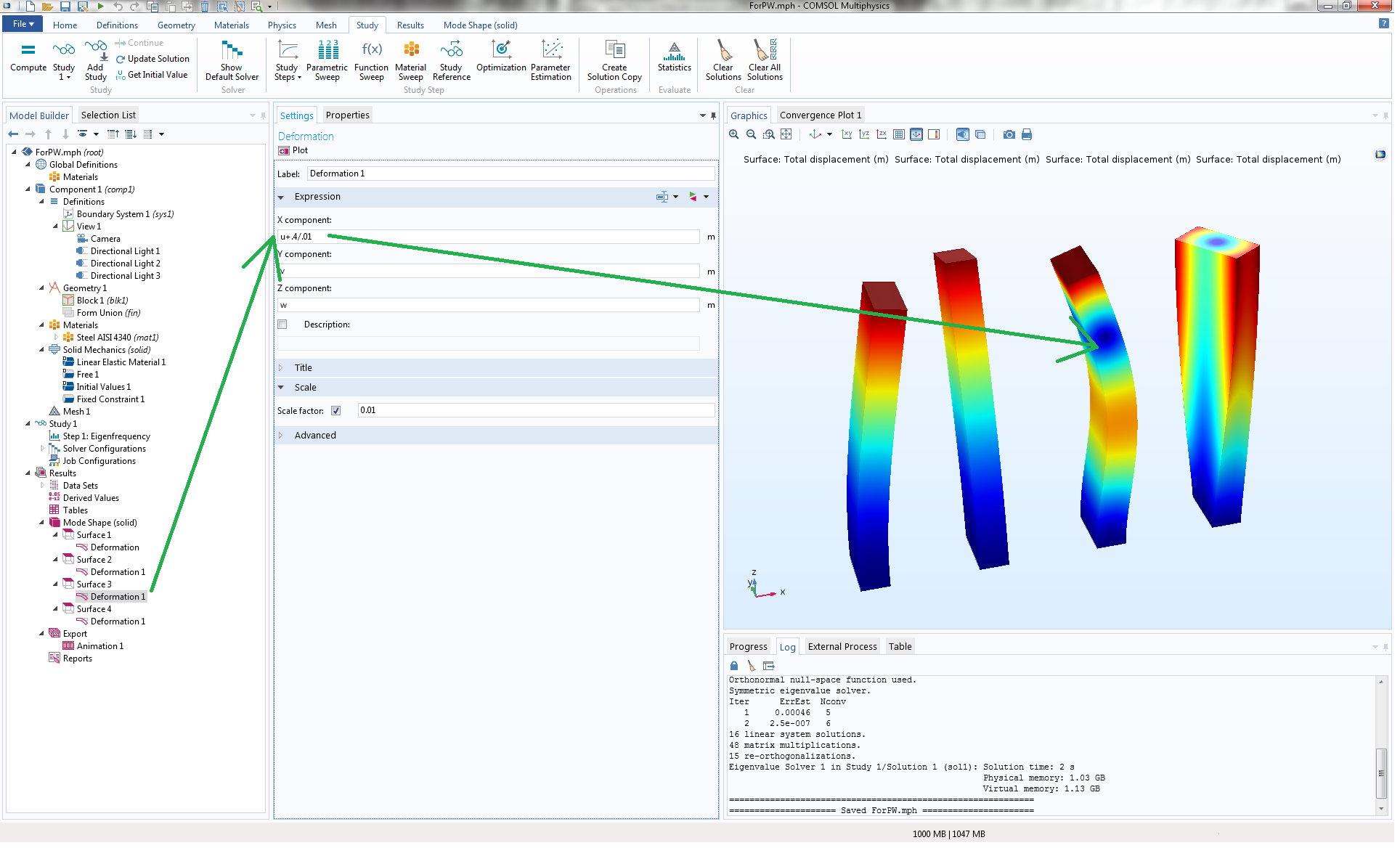

I have a MEMS model, where I simulate an actuated polymere on a foil. I calculate the eigenmodes of that and want to show all the eigenmodes next to each other in one 3D plot.
Additionally, it would be nice if you can animate the modes in this view. I could only animate one mode, yet.

Hello Patrick,
You can achieve that by using Deformation nodes, as shown in the attached screenshot and model file.
Hello Patrick, You can achieve that by using Deformation nodes, as shown in the attached screenshot and model file. Best regards, Jeff
