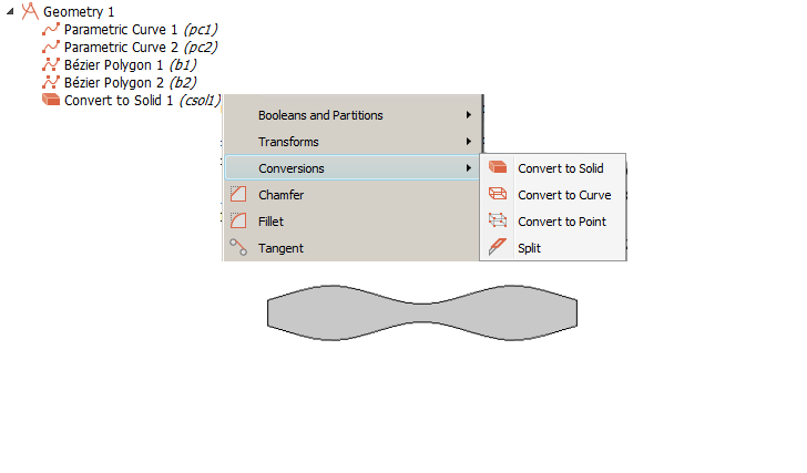

After creating geometry using parametric curve, I built union to make a close geometry from 2 parametric curves and 2 lines. I am not able to select this geometry boundaries in laminar flow physics. I am also attaching the input file. Please help.
Priyanka
Hi, After creating geometry using parametric curve, I built union to make a close geometry from 2 parametric curves and 2 lines. I am not able to select this geometry boundaries in laminar flow physics. I am also attaching the input file. Please help. Thanks Priyanka

Priyanka,
Use Conversions/Convert to Solid option, as shown in the attached image.
Sergei
Priyanka, Use Conversions/Convert to Solid option, as shown in the attached image. Regards, Sergei
Posted: 9 years ago 27 ott 2016, 08:52 GMT-4
Thanks Sergei.
