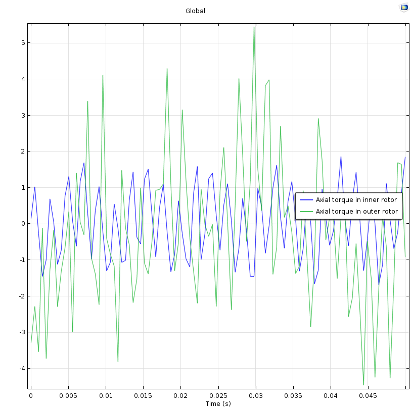

I'm working on the transient simulation of a magnetic gear. I'd like to calculate torque variations on inner and outer rotors.
I did exactly as what is written in magnetic gear simulation application note and I got the correct results for a magnetic gear with a halbach array. But when i change the remanent magnetic field direction in permanent magnets from halbach array configuration to radially magnetized configuration, I cannot get a correct solution. Torques on inner and outer rotors oscillate around the zero as the time increases. Radially magnetized configuration is studied in literature a lot, so I don't think the results are accurate.
What am I missing? Do you have any suggestions for this problem?
