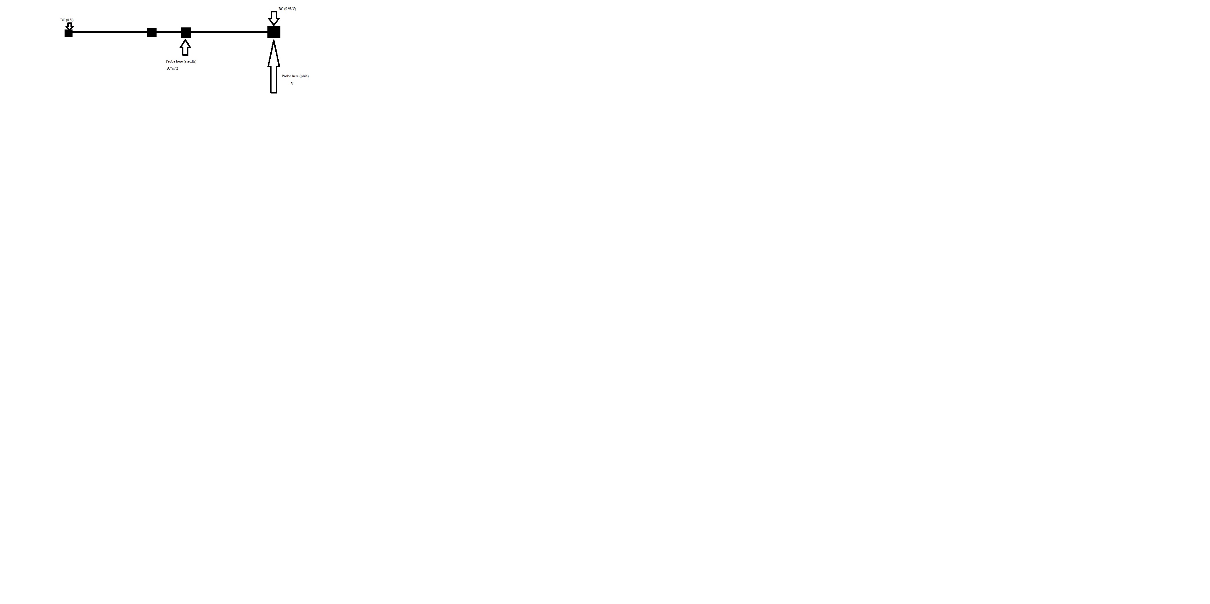

Sorry I can't open because it was created with a new version.
Open the file where I draw in Paint a conceptual scheme where you should place your probes.
Sorry I can't open because it was created with a new version. Open the file where I draw in Paint a conceptual scheme where you should place your probes.
Posted: 9 years ago 23 set 2016, 12:19 CEST
