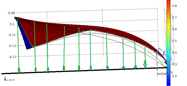

I calculate the pressure in some discrete points along a complicated geometry curve. The combination of the following tools brings me the pressure values.
1) Edge_3D (which is selected from the Data_Sets node) and
2) Line Integration (selected from the Derived_Values node) .
Concerning these values along the curve, I would like to project the corresponding points on a 2D plane, so that I can measure the horizontal distance between the points and the start. So far, I am only aware of the curve length till the point at which the corresponding pressure value is located.
