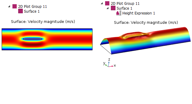

Sudha,
Use Height Expression option, as shown in the attached image.
Sergei
Sudha,
Sergei

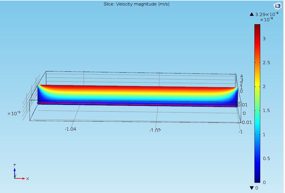

Respected Sir,
Thankyou for your response. I have tried as you have suggested. But it doesnt works. Indeed it takes the full area of the geometry. I have attached the profile for your reference. It is the segment of the circle cut using CAD and then we have imported in comsol to reduce time consuming. The channel is constructed btween two concentric circles and velocity profile of the fluid is generated in 3D. I need to show the only the profile of channel alone in 2D instead of showing in 3D as small image. Need to see the channel profile clearly in 2D.
Expecting your kind help.
