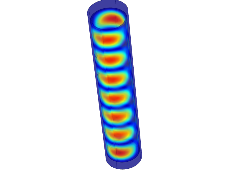

I was able to get modes by adding a scattering boundary conditions and an incident plane wave, like I said earlier and I got modes like shown in the image
But I can no longer get the same modes by running the same file, but I cant tell what/if anything's changed
