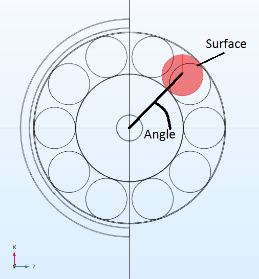

1) I am not only interested in the flux at one point; I need the flux at many points as I vary the (radial) position of the surface. Because I am interested in surface positions along a circle, only a single parameter (angle) need be swept for the surface position. I was hoping that there was some sort of "Postprocessing Parametric Sweep" option, but I don't see one. Being that position of the surface does not alter the solution, re-solving the system for each radial position of the surface (which is what happens if I use the regular "Parametric Sweep" tool) seems unnecessary; this should be limited to postprocessing only. Any advice on how I can compute angle vs flux in this way? See attached image.

I have a solution to a static 3D problem. The solution is a vector field in three dimensions. I am interested in finding the flux through an arbitrary surface as that surface moves through the solution domain. The result should be a table of position vs flux. The surface does not affect the solution, so I should be able to perform the integration at multiple surface positions entirely via postprocessing. I assumed that the way to do that would be some sort of "postprocessing parametric sweep," whereby I sweep the position variable(s) and compute the flux at each position. However, such an option does not exist in COMSOL. How would one go about doing this type of computation?
