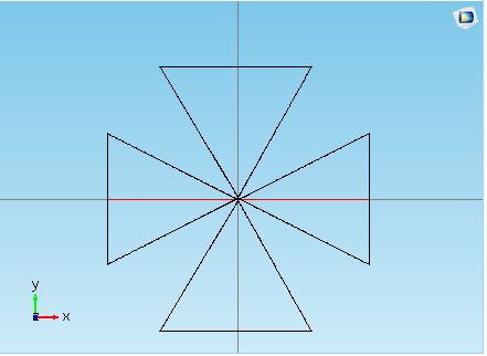

Problem: I have a defined antenna structure. I have simulated the e-field distribution on the surface. However, now I would like to see how the e-field changes with respect to time along a certain path or line in the structure? So, it is basically a 1D plot of time-varying e-field along a straight line.

I have attached my image file here. I would like to find the change of the e-field with respect to time along that certain path (red line). Please kindly let me how can I do that.

I have attached my image file here. I would like to find the change of the e-field with respect to time along that certain path (red line). Please kindly let me how can I do that. Thanks, Rishad

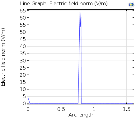

Well, If I do 1D plot>line plot along this red line, comsol generates the e-field distribution with respect to Arc length (I assume that is what you were saying E=E(x), right ? ). I have also attached the E(x) plot that I have obtained.

Thanks a lot Sir for your reply. I was looking forward for someone to response to my problem. Well, If I do 1D plot>line plot along this red line, comsol generates the e-field distribution with respect to Arc length (I assume that is what you were saying E=E(x), right ? ). I have also attached the E(x) plot that I have obtained. But if I now divide x- coordinate (arc length) by model frequency, then how it becomes E(t)? I am sorry but I didn't understand you point here. How the time is defined here in this case ? Please kindly let me know. Thanks, Rishad

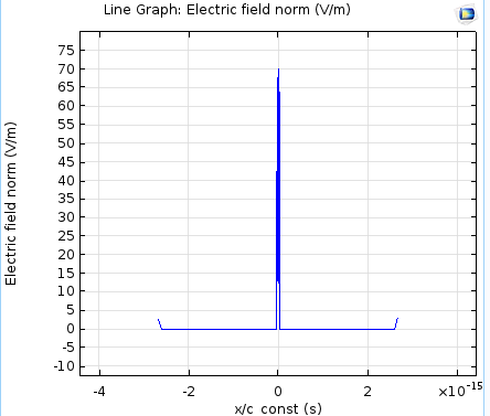

Sir, yes , I did the post processing in my simulation as you said but I was expecting something different than the attached figure (22).

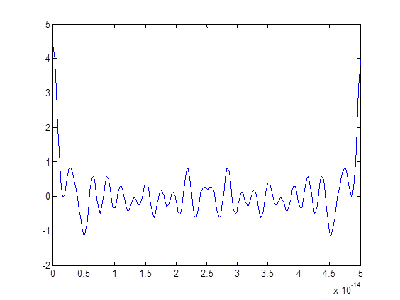

I was expecting a time varying e-field which is bidirectional in nature. Time very e-field means in this case- e-field in time domain. However, I have e-field distribution in f domain. How can I plot e-field from in t domain from that ?
I have also attached kind of similar plot which I was expecting. (attached 'expected', please ignore the scale in that case.) Please let me know what you think of it.

Sir, yes , I did the post processing in my simulation as you said but I was expecting something different than the attached figure (22). I was expecting a time varying e-field which is bidirectional in nature. Time very e-field means in this case- e-field in time domain. However, I have e-field distribution in f domain. How can I plot e-field from in t domain from that ? I have also attached kind of similar plot which I was expecting. (attached 'expected', please ignore the scale in that case.) Please let me know what you think of it. Regards, Rishad

However, by dividing the x coordinate /c_const doesn't make much difference in the plot. It's almost similar plot that I obtained for E-field Vs arc length, right? Moreover, there is also negative time in the fig when I divide it by c_const, how that can be explain , Sir ?
I want to insert the time step size and the final time for simulation. Like for example, from t=0 to t=100 s, how the e-field is varying with time along that path (red line). However, by dividing the x coordinate /c_const doesn't make much difference in the plot. It's almost similar plot that I obtained for E-field Vs arc length, right? Moreover, there is also negative time in the fig when I divide it by c_const, how that can be explain , Sir ?
