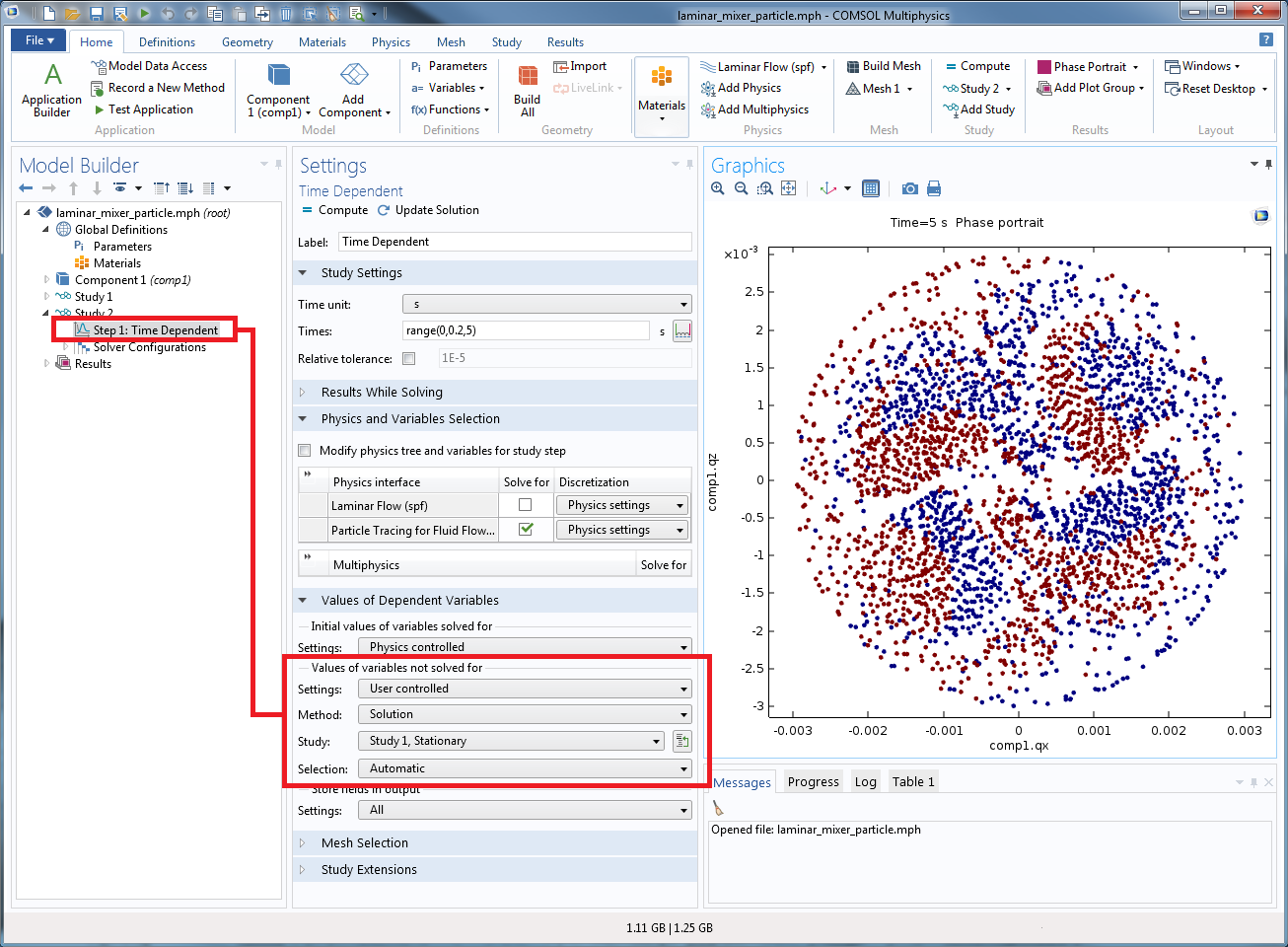

Hi Dan, Bill:
There are a couple of reasons why the error message "Zero or negative particle density" might occur, but if you're trying to make the initial density of particles at the Inlet proportional to the velocity magnitude spf.U, the most common mistake is to forget to set the "Values of variables not solved for" in the settings for the Time Dependent study. The "Values of variables not solved for" should be "User Controlled" and the "Study" should be a valid stationary or time-dependent study that has already been computed, in which the Inlet velocity is nonzero.
See the attached screenshot, taken from the tutorial "Particle Trajectories in a Laminar Static Mixer" [www.comsol.com/model/particle-trajectories-in-a-laminar-static-mixer-10644].
If you've double-checked the "Values of variables not solved for" and found that everything matches the setup in the tutorial, but you still get the error "Zero or negative particle density", then I'd recommend submitting your model to COMSOL support for further assistance.
Best Regards,
Chris
