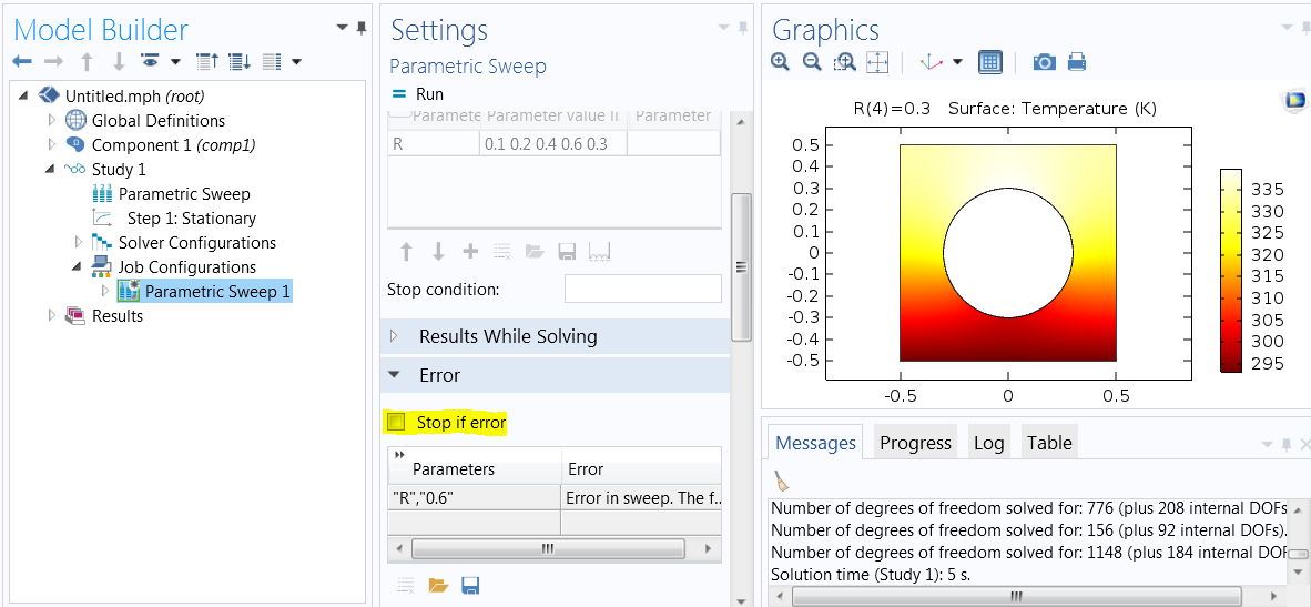

The setting that will probly help you can be found in
Study > Job Configurations > Parametric Sweep >
Settings Window > Error > "Stop if error"
If you disable this setting the solver will not stop but merely report that for a given parameter an error was encountered, all other solutions will be produced.
See my screenshot for explanation: The sweep contains a configuration R=0.6 for which the problem cannot be solved. The solver will return all others and report the error for 0.6.
I hope this will help you.
Sven Friedel
Hi Daniel, since the solution to your question appears to be not be well-known in the community, I take the opportunity to comment on it. The setting that will probly help you can be found in Study > Job Configurations > Parametric Sweep > Settings Window > Error > "Stop if error" If you disable this setting the solver will not stop but merely report that for a given parameter an error was encountered, all other solutions will be produced. See my screenshot for explanation: The sweep contains a configuration R=0.6 for which the problem cannot be solved. The solver will return all others and report the error for 0.6. I hope this will help you. Best regards, Sven Friedel

Posted: 9 years ago 24 feb 2017, 18:44 CET
I am trying to implement this solution in version 5.2a on Linux, and creating the Job Configurations node is not available.
Was this feature removed in the software update? Is it not available on the Linux platform? Is the feature now activated under a different node?
Any help would be greatly appreciated.
I am trying to implement this solution in version 5.2a on Linux, and creating the Job Configurations node is not available. Was this feature removed in the software update? Is it not available on the Linux platform? Is the feature now activated under a different node? Any help would be greatly appreciated.
Sven Friedel COMSOL Employee
Posted: 9 years ago 27 feb 2017, 08:58 CET
The feature "Job Configurations" appears when you either run the study or right-click on your study and click "Show Default Solver".
Sven
The feature "Job Configurations" appears when you either run the study or right-click on your study and click "Show Default Solver". Sven
Posted: 9 years ago 27 feb 2017, 16:05 CET
Thanks for the reply, Sven...
I wanted to follow up and write in here that I was only able to access the Job Configurations node after hitting the "show" button within the model builder and enabling the "Advanced Study Options" viewer.
After doing this, Job Configurations automatically became viewable and editable.
Jake
