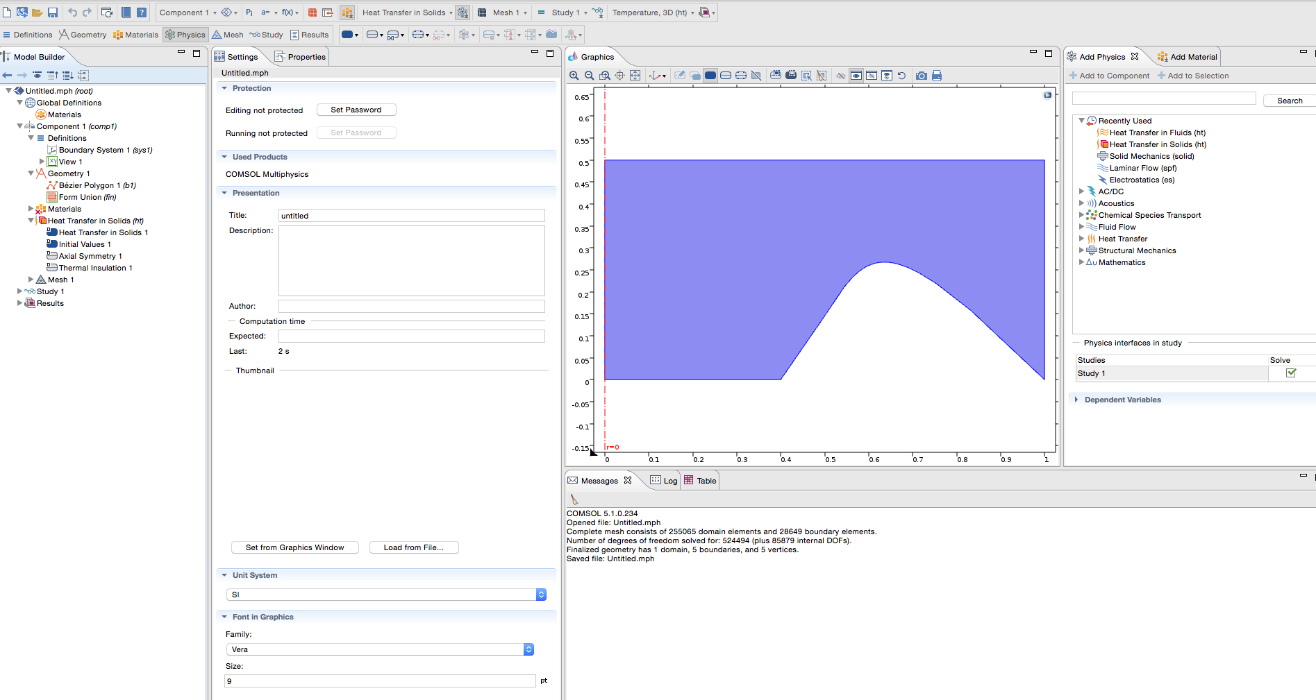

I'm sort of new to Comsol (3 days), but I can't seem to set up an object which has a constant temperature on two boundaries.
I'm using an axisymmetrical 2-D model, with the 'Heat transfer in solids'.
Attached is a screenshot of my model (proof of concept, so it's a bit messy) . I want the top to be fixed at 100K and the bottom to be fixed at ~270 K, and model the temperature inside the object.
Is there something I'm not doing, or not seeing?
Thanks,
-B
EDIT: I was able to figure it out (I guess I just needed some lunch): For anyone who stumbles in from Google: I just clicked a small bubble with a line through that printed 'Boundaries' when you mouse over it, and clicked Temperature.
