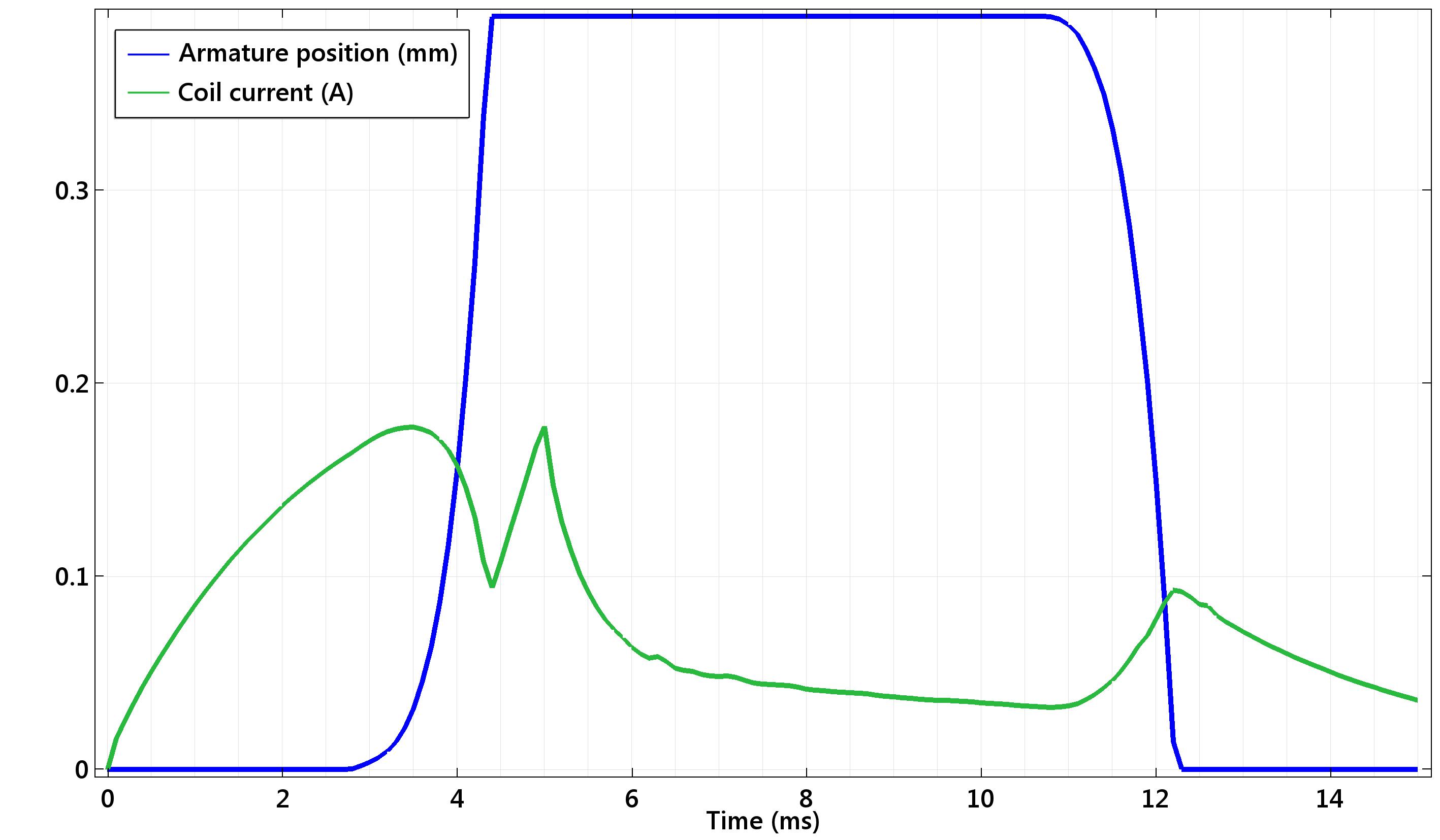

Posted: 9 years ago 13 giu 2016, 08:37 GMT-4
take a lot at this model
