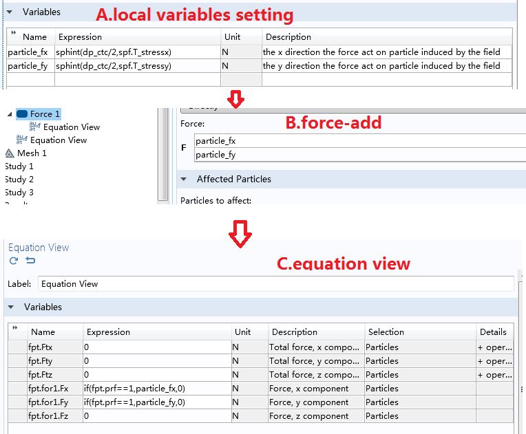

Lift Force(x)=sphint(r,spf.T_stressx); Lift Force(y)=sphint(r,spf.T_stressy);
The sphint(r, expr) operator computes the surface integral of the expression expr on the surface with radius r around the point in which it is evaluated.;r is the radius of the particle.

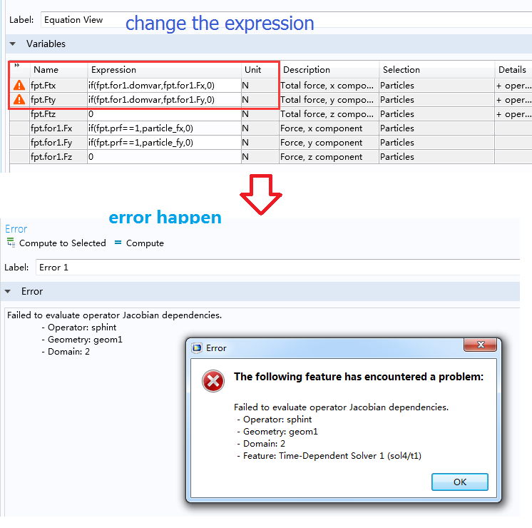

3、model particle tracing for fluid flow ,and "Force_x" =lift force(x),"Force_y"=lift force(y)
But the force seems like have influence to the particle, as "the particle inserted at a specific location in the straight channel remian at that location"
So, can anyone give some advises?
