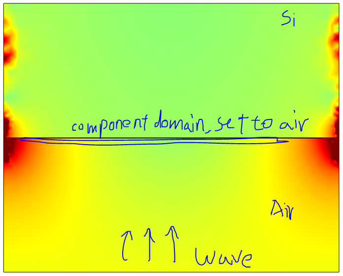

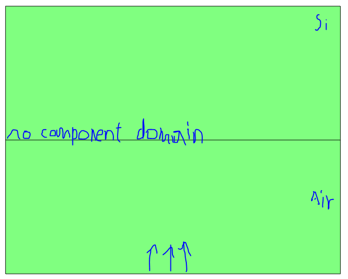

I am trying to build a model to calculate a component's absorption. The component lays on Si and the wave incidents from air to Si.
I use periodic PC and 2 periodic ports to calculate it. But the result is far to my expect.
So I made a test. I found that, if I set the component's domain to air, the E-field is still not the same as there is no component's domain,as the pics attached.
Am I wrong to build the model? What should I to fix this problem?
