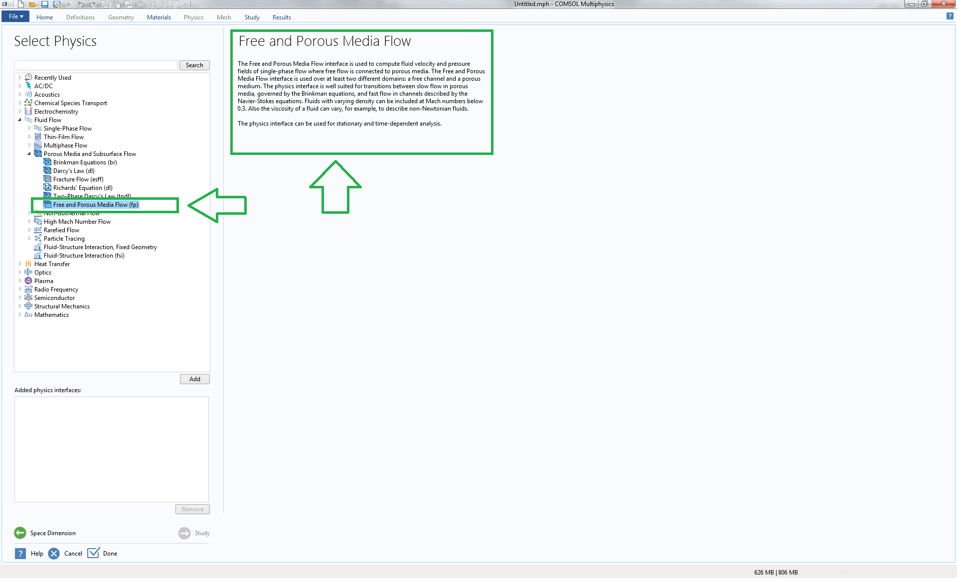

Depending on which licenses are included in your license, you may have access to a physics interface called "Free and Porous Media Flow" (see screenshot), which would make coupling of the (free) flow in the cannula to the flow in the (porous) adipose tissue much easier than doing it "by hand". If you do have access to that physics interface, you will find various tutorials for it in the Applications Libraries (under the File menu in the software) and Application Gallery (on the COMSOL website).
Hello Theodore, Depending on which licenses are included in your license, you may have access to a physics interface called "Free and Porous Media Flow" (see screenshot), which would make coupling of the (free) flow in the cannula to the flow in the (porous) adipose tissue much easier than doing it "by hand". If you do have access to that physics interface, you will find various tutorials for it in the Applications Libraries (under the File menu in the software) and Application Gallery (on the COMSOL website). Best regards, Jeff

I have looked over the free and porous media flow model, and this provided some insight. However, for my simulation, we are only interested in determine the time it takes for the insulin to flow from the cannula (inserted in the adipose) to the 'bottom' of adipose tissue, where a blood vessel might be perhaps.
Jeff, I have looked over the free and porous media flow model, and this provided some insight. However, for my simulation, we are only interested in determine the time it takes for the insulin to flow from the cannula (inserted in the adipose) to the 'bottom' of adipose tissue, where a blood vessel might be perhaps.
