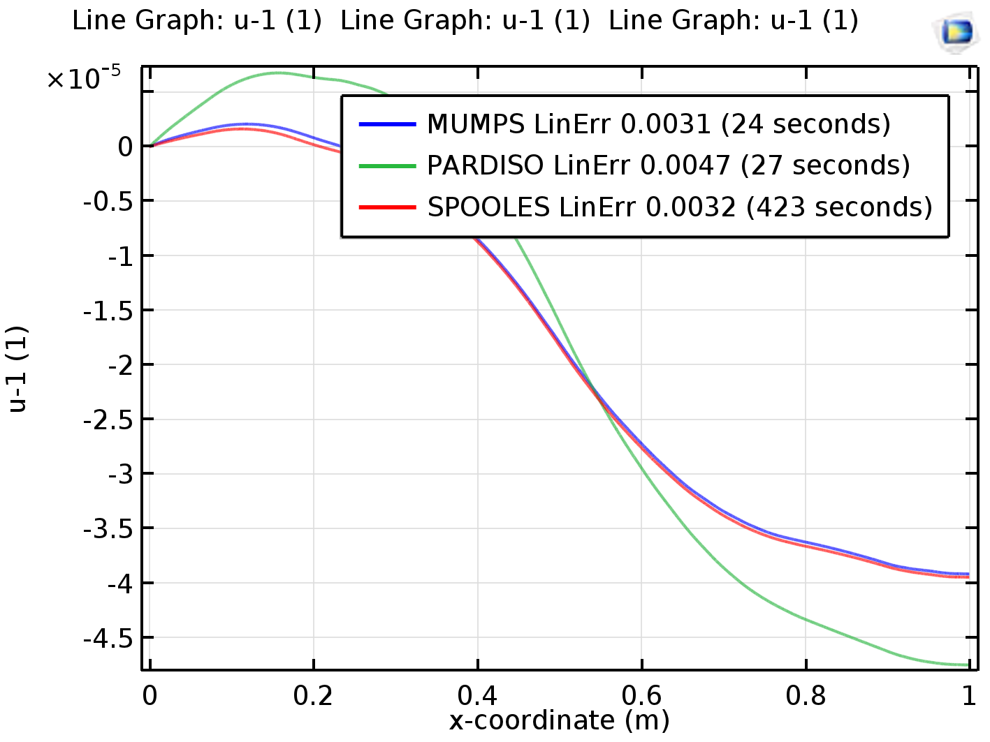

Having had some problems, I reduced them down to a surprisingly minimal example:
• 1D, single interval, Laplace equation.
• Dirichlet BC on left end: fix it at "1.0".
• (There is a zero-flux BC on the right end by default.)
• Mesh has 500,000 equally-sized elements.
• Everything else is at default values.
The result comes back with a massive error (see the plot, attached) and relative error indicator (LinErr) of 0.0031 (MUMPS), 0.0047 (PARDISO), 0.0032 (SPOOLES).
The error is solver-dependent for the three direct solvers, which should all be, theoretically, producing the same answer. But they are not, as can be seen from the residual plot. All answers are bad by at least 0.0003 at the free end. So we only get 3 significant figures accuracy out of this trivial simulation.
Of course it's clear that this has something to do with numerical errors accumulating due to the large number of elements. However, 1 million DOFs doesn't sound like a big job for Comsol.
Typically we expect the error to decrease as we refine the mesh further and further. But with this example, the error keeps increasing:
Elements DOFs LinErr
500 1001 4e-8
5000 10001 2e-6
50000 100001 4e-4
500000 1000001 5e-3
So instead of converging to the right answer with mesh refinement, it diverges!
I was under the impression that these sorts of effects (when the mesh becomes too fine) won't come into play until some very large numbers of elements that we never need to worry about. This seems to be wrong now, and is a nuisance, because now it works against error estimation by mesh refinement. I don't really understand the nature of these errors, actually, beyond the imprecise "accumulation of round-off and discretisation errors". It would be good to get a feel for how fine is too fine, for different types of problems and geometries. Any ideas?

Hi, thank you Henrik and Daniel,
The condition number being a function of the level of refinement was indeed the key to my problem.
However, the cube example is at the opposite end of the spectrum, i.e. one of the safest possible models as far as condition number is concerned. Yes, 1D problems are not typical, but slender 2D problems are common enough to encourage the need to be mindful of these issues (well, I'm working on one right now).
After a bit of experimentation in 2D with NxM grids, it seems that the longest edge (in terms of the number of elements, so max(N, M)) determines the condition number in exactly the same way as running a 1D simulation with N elements.
The next question that arises is: what is the effect if we have some coarse areas and some densely meshed areas? To look at answering this, I've built a simulation with a few horizontal layers, of thicknesses 1, 2, 4, 8, ..., n^2, ..., 2048, and meshed the edges between them with 40960/thickness vertices. Meshed the domains with Delaunay triangular mesher. Applied Dirichlet BCs (= 1) on the left boundary of the model. (Model is attached, but note it does take a long time to mesh.) The results are:
