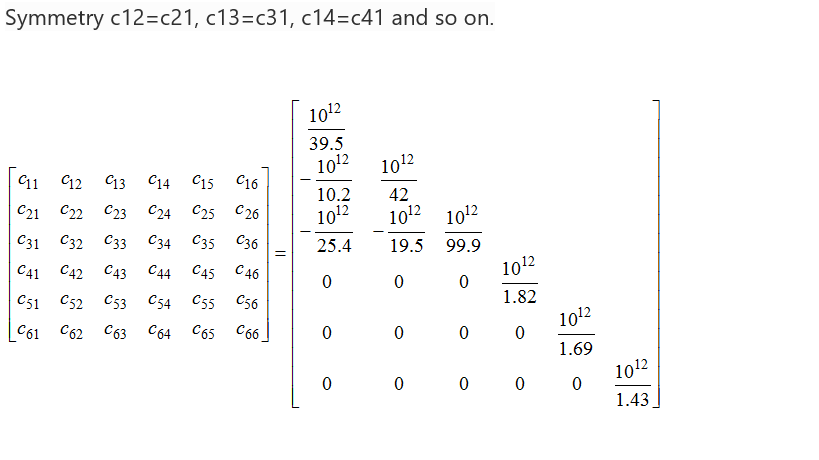

Can you please kindly mark all the individual components of the elastic matrix (cE unit is Pa) (6*6).

Please find the answer in attached file. To get more information, I recommend to visit this link as well:
www.comsol.com/community/forums/general/thread/27159/
Hi Please find the answer in attached file. To get more information, I recommend to visit this link as well: https://www.comsol.com/community/forums/general/thread/27159/
Posted: 8 years ago 4 mag 2017, 13:01 GMT-4
Thanks a lot. I really appreciate your help to answer my queries.
