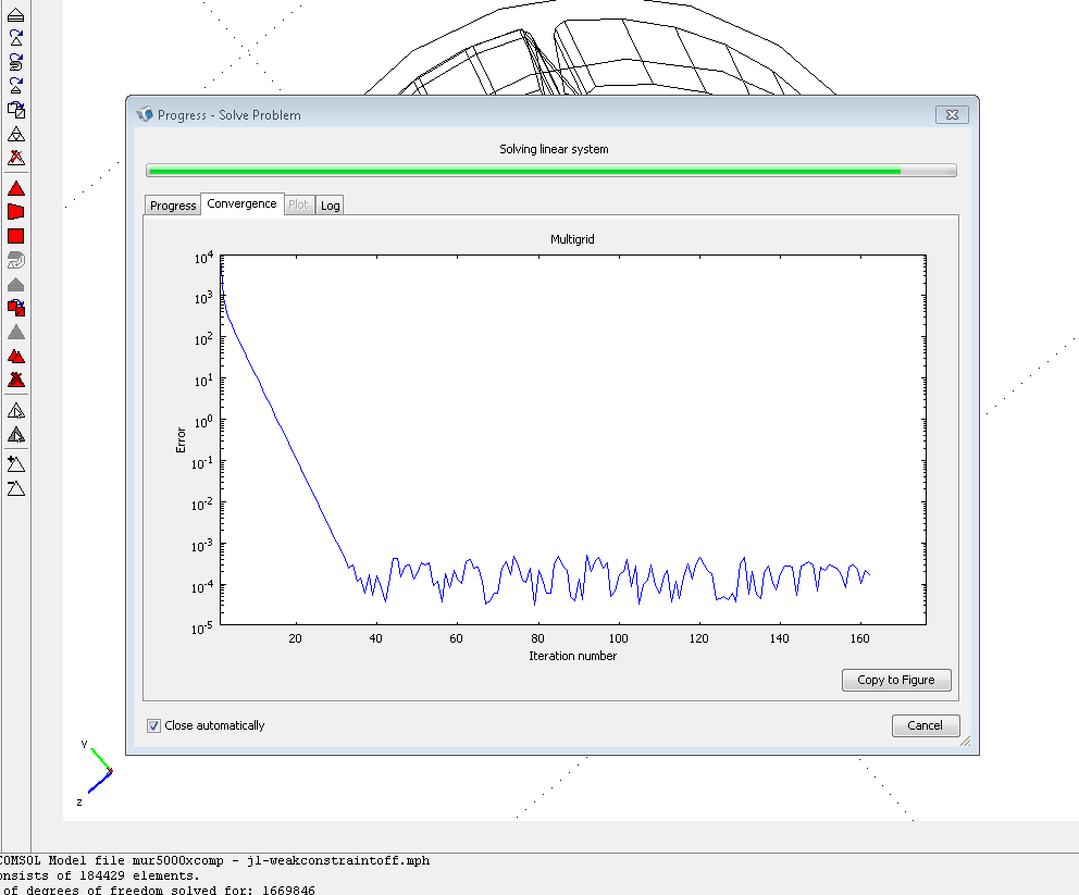

Hello everybody, I have several simulations in comsol 3.5a and after several iteration it goes to a distorting curve the same as the figure I added. The solver goes to 99pecent but return back to 80-90 per and this may repeat and repeat for more than 20-30 hours even with a computer with 191GB RAM and 16 cores CPU. Will the answers be wrong if I stop the process when it is very close to the relative error? (E.g. relative error is 1e-5 but it goes to 1.5e-5 and then returns to e-4 and so on).

obviously your model is set-up such that you cannot reach the relative precision desired. Normally if you STOP it (not cancel) youre last results are stored (you have also options to store intermediate results, the easiest is to use a parametric sweep) but you must check that the one active with your stop is really one with error estimates at the "grass level" as the solvers sometimes make some jumps around and the last might not be the "best of the last solutions"
It's probably linked to the mesh density, perhaps in some critical region that has a great influence on the results, you might try a mesh refinement, all depends on your model
Hi obviously your model is set-up such that you cannot reach the relative precision desired. Normally if you STOP it (not cancel) youre last results are stored (you have also options to store intermediate results, the easiest is to use a parametric sweep) but you must check that the one active with your stop is really one with error estimates at the "grass level" as the solvers sometimes make some jumps around and the last might not be the "best of the last solutions" It's probably linked to the mesh density, perhaps in some critical region that has a great influence on the results, you might try a mesh refinement, all depends on your model -- Good luck Ivar
