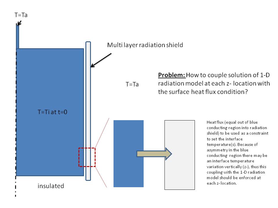

does anyone know how to use a (two-way coupled) 1-D model to establish the boundary condition to a 2-D model that varies with location? Attached figure summarizes the essence of the problem. I want to solve asymmetric cooling of a solid block that is insulated on the outside with a multilayer radiation shield (multiple Aluminum foils with spacer between them, for example). Radiation part is essentially 1-D but its solution can depend on where on the 2-D surface it is solved.Anyone have any suggestions or can point me to some similar example models? I have both version 3.5a and 4.1
