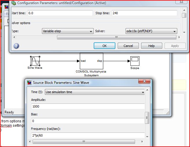

<<PLS help me out, the problem is that i do not scope the desirable curve!!>> Grateful for your help!
I want a sin curve and i extract a line.!
Any suggestions??

SIMULINK circuit the attached jpg photo
