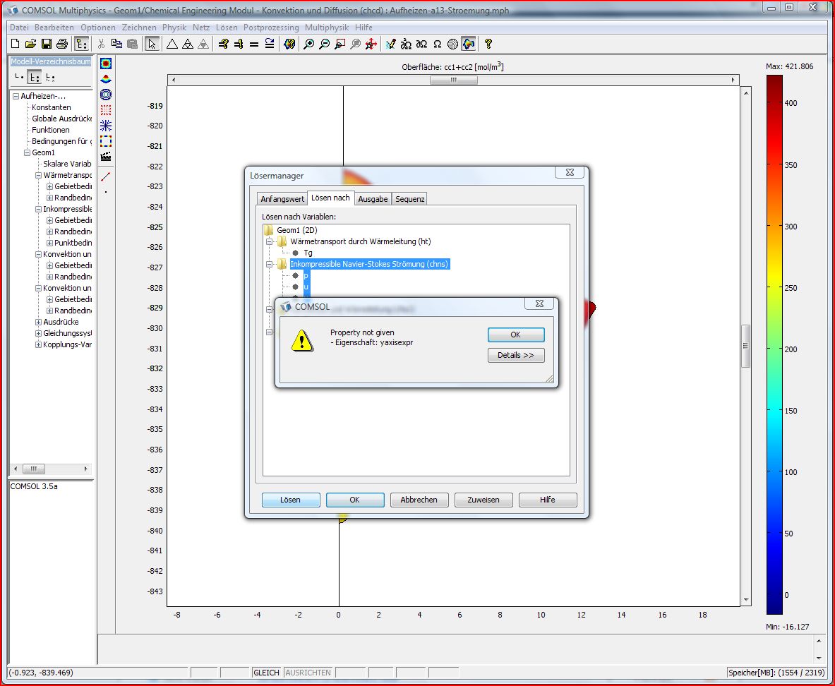

Is there anybody who knows this error:
"Property not given: yaxisexpr"
My model gets a stationary solution. After restarting the simulation to get a transient solution I get this error.
** Now I get the error by using the parametric solver AND restart, too!
Exception:
com.femlab.jni.FlNativeException: Property not given
Messages:
Property not given
- Property: yaxisexpr

I had the same problem. First static solution, then frequency response.
The error was because I had defined a "probe plot parameter" that was not defined anymore. After deleting the probe the error was gone. Had nothing to do with yaxis or so (it was a global scalar variable).
