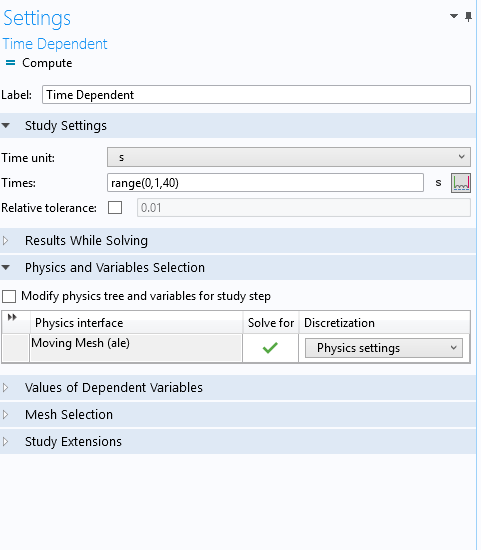

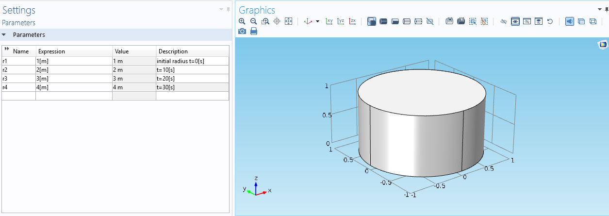

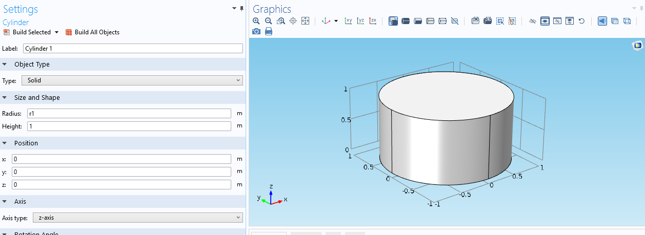

i wonder if i can change the geometry with time?
i want to change radius of cylinder with certain time intervals.
My process time is 40 second and i want to change radius of cylinder 4 times every 10 seconds

maybe you can define a piecewise function for the radius in your model, which takes a new value after every ten seconds (so as a function of time). If the name of the function is e.g. my_radius, then enter my_radius(t). Hope that works, it is the only idea I have to implement what you want.
