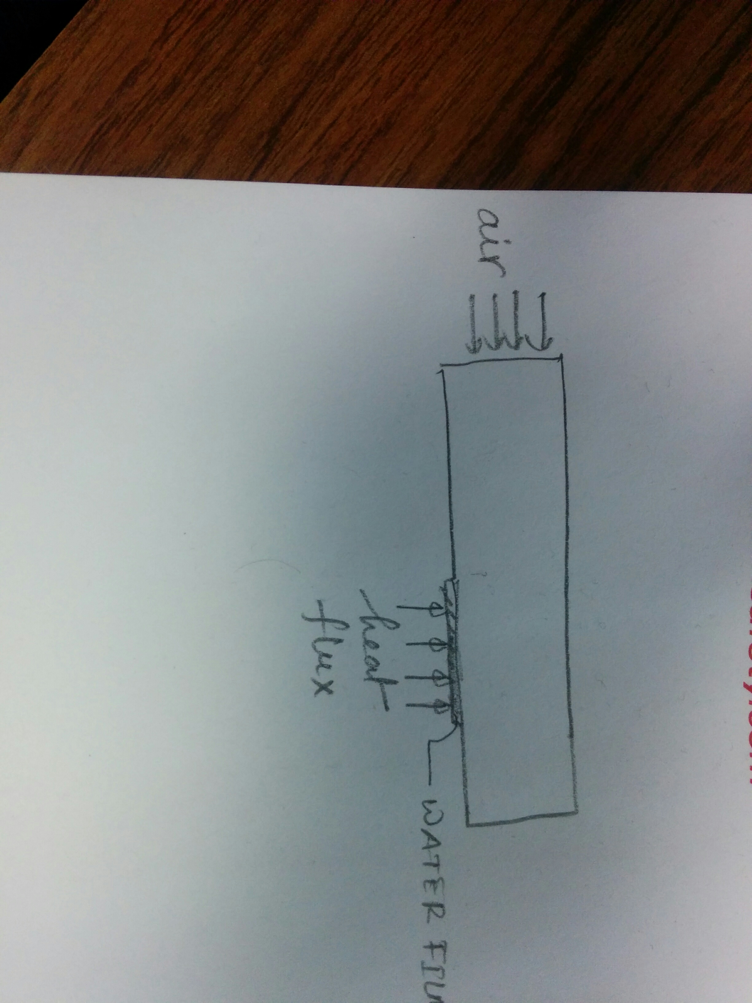

Hello! I am modeling a conjugate heat transfer problem. It is a closed channel flow of air and a thin liquid film at the bottom surface. In comsol model, first I like to add study for steady state case with no liquid film. Then I like to add the water film and run a time dependent in-transient case. For the 2nd Study, I need to solve for energy, and it would take the velocity profile of the steady state solution as the initial condition.
My first question is, to add liquid film, do I need to add New Component in my comsol? and the second question is, how can I use the steady state solution for previous study to initiate the second study?

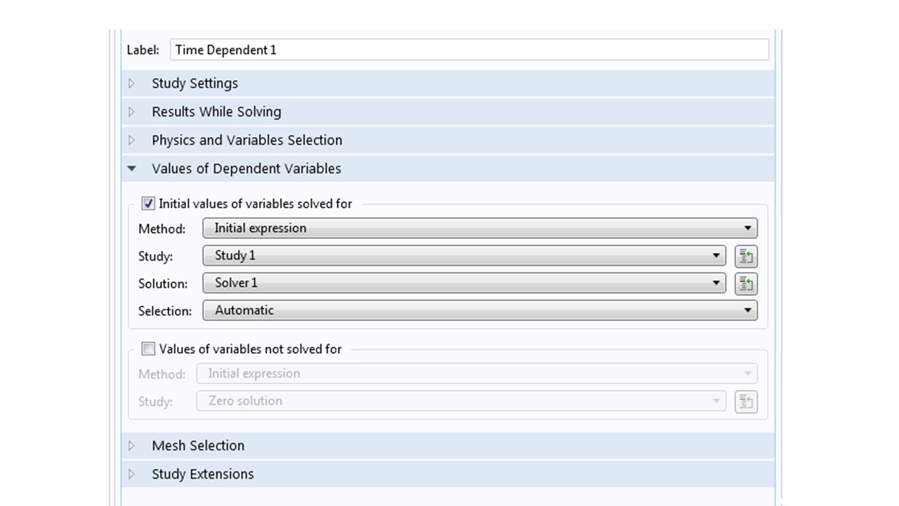

Loot at the attachment.
BR
Lasse
Hi Loot at the attachment. BR Lasse
Posted: 10 years ago 26 gen 2016, 04:38 GMT-5
Sorry, in the "Method" box ,an option "Solution" must be selected.

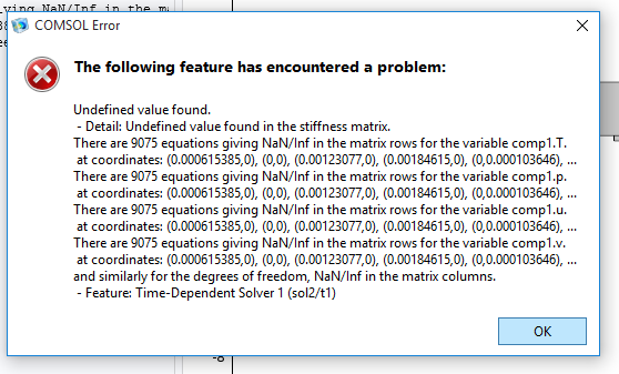

I have done this but it is showing this message:
please find the attachments. I have also attached the comsol file.
In study 1 I need to solve only the Laminar Flow (spf). So on study 1, Step1Stationary, I only checked the box for spf and unchecked the conjugate heat transfer (nitf).
Then study 2, I have solved for Conjugate heat transfer (nitf) by unchecking the spf. and checked the ''Initial values of variables solved for'' and selected Study 1 for study option. but it shows error. Would you please have a look. Thank you.
I have done this but it is showing this message: please find the attachments. I have also attached the comsol file. In study 1 I need to solve only the Laminar Flow (spf). So on study 1, Step1Stationary, I only checked the box for spf and unchecked the conjugate heat transfer (nitf). Then study 2, I have solved for Conjugate heat transfer (nitf) by unchecking the spf. and checked the ''Initial values of variables solved for'' and selected Study 1 for study option. but it shows error. Would you please have a look. Thank you.

I solved your model with version 5.2 without any trouble. In Initial values of variables solved for, I changed Selection to Automatic.
