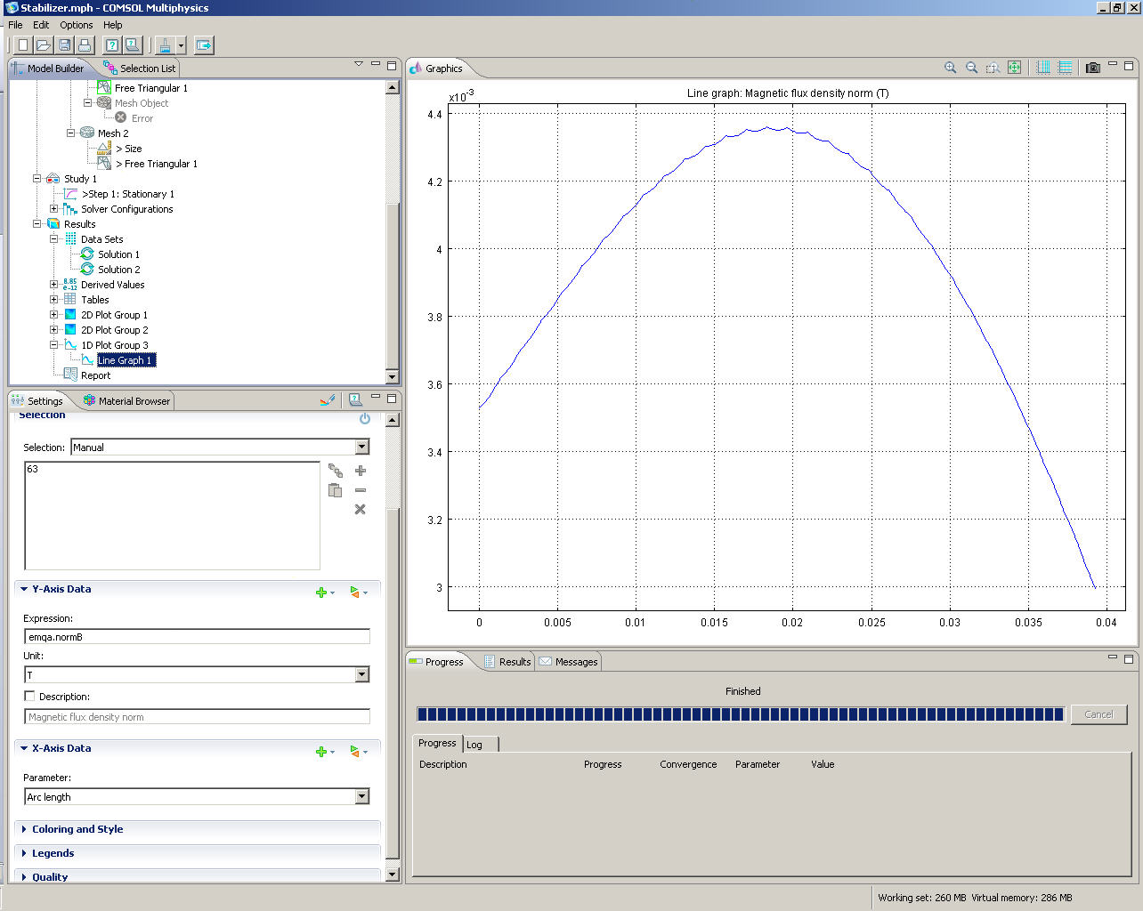

you can also do a 1d plot of the flux density over the line.
I tried to refine the mesh and got a plot like the one shown on the attached jpg.
guess your first mesh was a bit too rough around the line 63.
