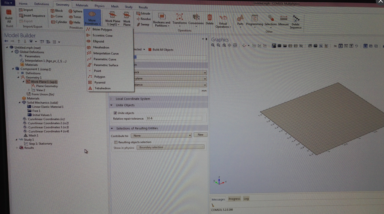

I am learn from the cases in the official web, in a case, the guide said I should choose "circle" in the "geometory". But there is not the "circle" in the "geometory" in my software. thank you!

Dear Chen, you can't create a circle in 3D but a sphere or a cylinder. To create a circle you should use a workplane first.

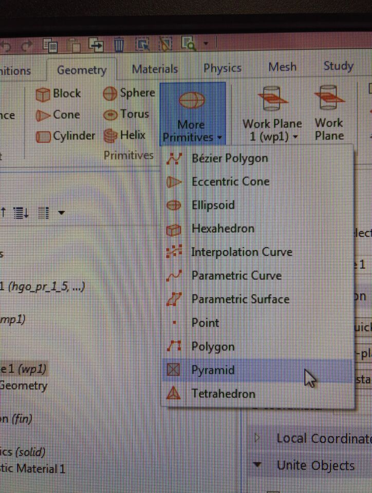

Dear Piquerel, thank you for your reply. I tried it again also with the workplane but there is still no "circle".

You have to click on the "Plane Geometrie" (in the tree view) first!
Dear Chen, You have to click on the "Plane Geometrie" (in the tree view) first!

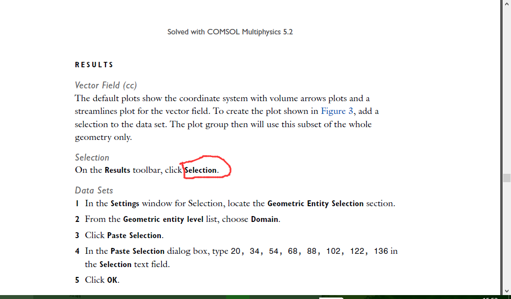

thank you very much for your reply, and I have another doubt with the example titled <<Anisotropic Heat Transfer through Woven Carbon Fibers>> on the page 13 of the pdf, I can find the "selection" button but the button is disable. I have tried a lot of times, but it is still disable. I made a screenshot in the attachment, could you help check this. Thanks a lot.

thank you very much for your reply, and I have another doubt with the example titled on the page 13 of the pdf, I can find the "selection" button but the button is disable. I have tried a lot of times, but it is still disable. I made a screenshot in the attachment, could you help check this. Thanks a lot. best regards, chen

Thanks, renaming the file did the trick.
You're right, a step is missing in the instructions. Where it says
"Selection
On the Results toolbar, click Selection"
it should say instead
"Selection
In the Model Builder, select the Results > Data Sets > Study 1/Solution 1(sol1) node
Thanks for pointing it out.
If you find other issues with the documentation, we recommend that you please report them to support@comsol.com . While a few COMSOL employees occasionally contribute to the Discussion Forum, we do not keep that close an eye on it.
