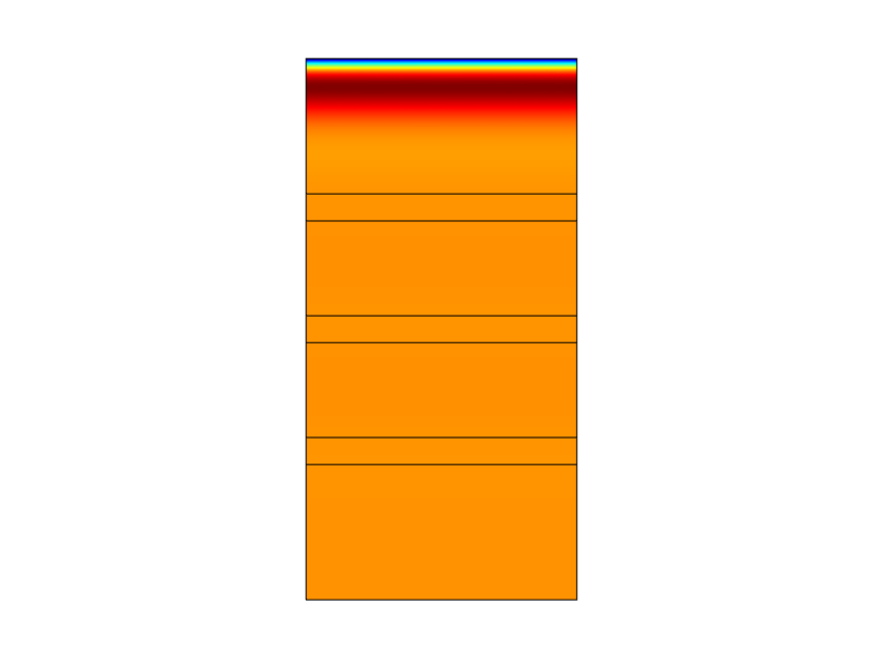

I just slightly modified your previous model by changing port BC to two scattering BC (on the top and bottom) so that you can excite a plane wave from top to bottom through two PMLs. Particularly, I put a dielectric layer in the air domain with n=2 (SiN) and probe the powerout flow along one boundary near bottom PML. It looks like this model now works well. FYR.

I see your modified configuration to my model.As result I see a surface plot where the field is overall zero except close the top PML (becouse it has been absorbed, i suppose).It don't seem to work well, I mean i don't see the field inside the domains.I want a configuration (PML+Port was the best case in previous versions) for witch i can excite a plane wave in the interior domains and it can be scattered by any possible scattering object inside them.I need the PML on top and above side in order to absorbe any scattered component of the wave.

I still have no idea how I can set "Boundary Pair" using 4.0a. However, the model I modified really works. You need to do another run but with no dielectric layer in the air domain to get background field. Then, you just divide the two integration values along the bottom BC ( one is with dielectric layer, the other is without dielectric layer) so that you can get the transmittance. You don't need to care about the field in the air domain since you only need the normalized value. That's what I did.
