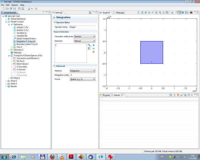

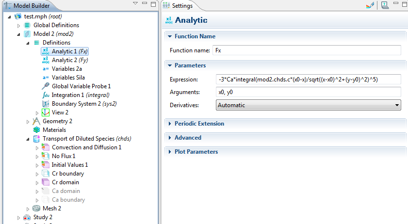

c variable is dependent variable of my model (at picture it is mod2) so I assume it is defined on domain and boundary.
integration1 (Integral) is defined on domain (second picture).

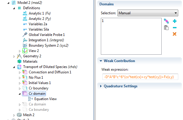

function Fx is used in domain weak contribution (third picture).
So I think all should be OK, but it does not work.

The expression that you have defined is perfectly valid in the physics settings of a model, so you should use it directly in an edit field for a force component, for example.
Analytic functions do not recognize any other arguments than the ones that you define in their Settings windows and any global parameters that you have defined. That is why you get errors when using dependent variables and integration operators, for example, in an analytic function definition.
