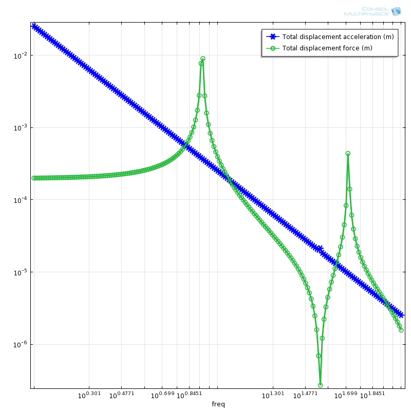

If you apply a shaker test (on a beam just to have an example) you have basically (at least) 2 possibilities:
1) you place the full system on the shaker and you apply a body load from the acceleration of the shaker (your fixed point is also shaking ! hence this is not "just" using the acceleration boundary or domain body load on a fixed lever
2) you attach a boundary to the shaker and you apply locally an excitation force, but the fix point is "fixed" inertially
the responses are different see below.
Take a beam 1, 0.1, 0.01 m^3 (x,y,z) size in structural steel. Attach "fixed" boundary 1 (the first small 0.1x0.01m^2 or y,z plane side), load boundary 6 (the other end of the beam) with an acceleration and then with a Force (both in Z), and do a harmonic scan of the type f=10^{range(0,0.01,2)}
then plot in log/log (or adapt to dB) mode the average "w" or "disp" value of the excited boundary "6" you will not get the same response.
Then, try a domain acceleration => its all wrong so long you do not replace the "fixed" boundary condition by something adapted to the acceleration motion,
something to think over ;)
That is why using COMSOL is fun, you can test quickly on simple examples without braking anything

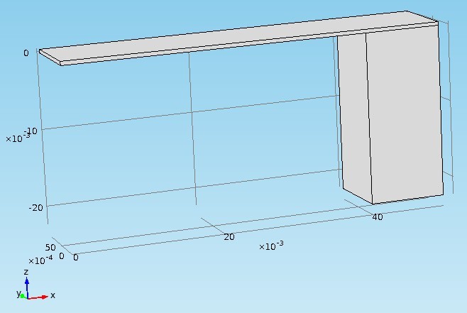

Hello everyone,
I've got a similar problem with a simulation of a vibration test. For easy understanding and a fast simulation I have simplified the model to a beam with the dimensions 1m * 0,02m * 0,02m (x, y ,z), which is fixed on the left end. Now this cantilever should be excited by an acceleration, but I don't know how to define this acceleration in the simulation. The first try was to define a boundary "prescribed acceleration" at the fixed end of this beam, but then the first condition gets overwritten, which is definitely wrong. I've also tried to simulate the beam of Ivar and the same results came out, but this is not the same task. I need a frequency-acceleration plot of this model, where the acceleration amplitudes of this cantilever can clearly be seen due to the eigenfrequencies of it. For example (acceleration of 5 m/s²), for the first 10 Hz there is almost a constant acceleration of 5 m/s², but at the first eigenfrequency of about 16 Hz there is a gain of xxx Q. After that the acceleration goes down and gets higher again at the second eigenfrequency, and so on.
So, how can I simulate this task, where should the acceleration act and also which kind of acceleration should act?
Thank you in advance for your help!!

Posted: 1 decade ago 19 apr 2012, 05:57 GMT-4
what about using a body load of solid.rho*acceleration. If you want to do a sinus load case, try the frequency harmonic solver with a frequency span start-stop, and perhaps a frequency dependent acceleration.

Posted: 1 decade ago 19 apr 2012, 08:19 GMT-4
Hi Ivar,
thank you very much for your answer. I've tried to use a body load and have a question about the simulation results. The acceleration peaks are not realistic, aren't they? And how do I get realistic stress results? If I choose von Mises stress at the eigenfrequencies the stress is much too high. The results are important, because with these values it is possible to choose the right material and/or geometry. The same thing happens if I choose a geometry of 1*0,2*0,2m, where the maximum acceleration is about 1400g...
Another question to your answer, how can I apply a harmonic body load and where can I find the frequency harmonic solver? If I right-click on body load and choose "Harmonic Perturbation" it should be harmonic, but if the simulation gets computed the acceleration is really small (about 1e-4). Do I have to set something else? Or do I have to choose the "Frequency-Domain Modal" Analyses? Because there I get some results, which aren't too low or high...
Last question, how is it possible to generate a PSD curve? I think this is just possible in the time-dependent analyses, isn't it?
Thank you very much for your help!!!!
PS: You can find a acceleration over frequency plot in the attachment of the cantilever example (1*0,02*0,02m) with 5 m/s² body load (steel). Are the results right?

Posted: 1 decade ago 19 apr 2012, 10:23 GMT-4
I'm not by my WS so I cannot test it out, but why shouldt the amplitudes be correct ? If you apply a body load of g_const*solid.rho its gravity load, and this has always worked for me ;)
What you might see is the Q facor amplification, when you excite the resonance, have you added some damping in your system ? to make it more ralistic ?
Normally, the stress is related to the displacement, so if the displacement is not realistic, certainly the stress is neither not correct.
Have you found the frequency domain solver, check the equation view to see what you can do and what is considered.
One can transfor a PSD to an equivalent frequency sinus sweep response (in LTI system) check the web on virations loads, our the litterature

and to add a little more, the prescribed acceleration on a "otherwise fixed" base, works OK with the Frequency Domain solver, but I cannot get it to work with Frequency Domain Modal solver, as I havnt found out yet how to apply a harmonic perturbation on the "acceleration".
And I want to correct my too quick remark earler hereabove, a distributed force load (or body load), and a prescribed acceleration are not look fully the same, as the transfer functions varies. For a prescribed base acceleration you need to analyse the difference between the point on the object and a reference point on the moving/accelerated "base"
A third method (at least present in 4.2a) that does work in Frequency Domain Modal is to apply a Force on teh otherwise rigid base, such as total_mass*g_const.
Note there is something else with the Frequency Domain - Modal studies refgarding the amplitudes. as there are two places where to define amplitudes (and damping), at the BCs and at the modal solver node
This needs some more testing before I can say I master it fully ;)

First how to simulate body loads with different materials ?
that is easy: as you define the load as a density in N/m^3 or simply g_const*solid.rho
This way you distribute the load on each mesh element depending on its local density (also valid for a density that might vary with the position in a domain). You can also say that you know the totoal mass, and acceleration F= Mass*g_const. Then COMSOL will distribute that AVERAGE force value onto each element, not exactly the same and certainly not for different domains with different densities
2nd point acceleration or body load ?.
I say that both work with a frequency domain sweep, but the prescribed acceleration does not work (for me, I might have missed something) for the frequency domain - modal analysis, as I cannot set the harmonic perturbation option on prescribed acceleration loads.
I was too quick in my first reply, and forgotten that a body force random excitation is not exactly the same as a random prescribed acceleration (from the base) excitation. The transfer functions differ, in one case its x, in the other case its (x-xbase) relative motion you are looking after.
But if you have a complex model Frequency domain might be heavy to solve, while frequency modal is rather quick and precise enough if you sort out the main modes

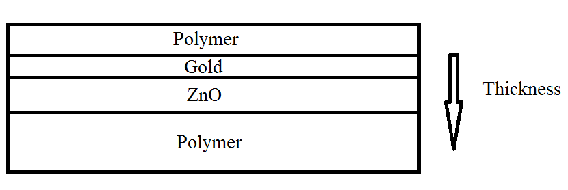

For some reason I am still not able to simulate the frequency response. I have a cantilever beam which has 3 layer (very thin though 80 nm) of 3 different materials. I have calculated the resonance frequency but the frequency response still does not work. I work in a frequency domain far away from the resonance frequency of the resonator. BUT STILL does not work. "Failed to find a solution for the initial parameter. The relative error (X) is greater than the relative tolerance Returned solution has not converged." It's frustrating!!!!!!! I have tried refining the mesh size, but it does not work either. I am planning to build an accelerometer based on this model.
I am attaching my model. Please, please suggest what should I do!! Also suggest any correction in the "PIEZOELECTRIC DEVICE" node, for obtaining voltage and charges.
Thank you,
Sankha
Hello, For some reason I am still not able to simulate the frequency response. I have a cantilever beam which has 3 layer (very thin though 80 nm) of 3 different materials. I have calculated the resonance frequency but the frequency response still does not work. I work in a frequency domain far away from the resonance frequency of the resonator. BUT STILL does not work. "Failed to find a solution for the initial parameter. The relative error (X) is greater than the relative tolerance Returned solution has not converged." It's frustrating!!!!!!! I have tried refining the mesh size, but it does not work either. I am planning to build an accelerometer based on this model. I am attaching my model. Please, please suggest what should I do!! Also suggest any correction in the "PIEZOELECTRIC DEVICE" node, for obtaining voltage and charges. Thank you, Sankha
Posted: 1 decade ago 16 mag 2012, 16:21 GMT-4
first a few suggestions to make it easier to work on your model
1) learn how to use the "Layers" in the geometry block tabs, you will build your models quicker
2) Add a second view and turn off the "Preserve aspect ratio" its easier to check your model
3) I didnt expect Au to be Piezoelectric, and as its really thin you could model it as a "thin" layer
4) you have really few elements in the thickness, I would not work without a minimum of 3 per layer
5) your electric potential is not connected
6) if you have done many changes, it's sometimes worth to rebuild the model from scratch as COMSOL sometimes get disoriented in it's internal settings
If I add a stationary study and connect your potential to the top surface it gives some results, but it fails if I choose the plane underneath the GND plane, but I cannot say I fully understand the three first layers
Sorry but I'm not sure what is wrong here, apart I would suggest to use a more up to date version
Hi first a few suggestions to make it easier to work on your model 1) learn how to use the "Layers" in the geometry block tabs, you will build your models quicker 2) Add a second view and turn off the "Preserve aspect ratio" its easier to check your model 3) I didnt expect Au to be Piezoelectric, and as its really thin you could model it as a "thin" layer 4) you have really few elements in the thickness, I would not work without a minimum of 3 per layer 5) your electric potential is not connected 6) if you have done many changes, it's sometimes worth to rebuild the model from scratch as COMSOL sometimes get disoriented in it's internal settings If I add a stationary study and connect your potential to the top surface it gives some results, but it fails if I choose the plane underneath the GND plane, but I cannot say I fully understand the three first layers Sorry but I'm not sure what is wrong here, apart I would suggest to use a more up to date version -- Good luck Ivar
Posted: 1 decade ago 16 mag 2012, 17:17 GMT-4
Ivar,
First let me thank your for your quick and detailed response. I have few questions regarding your suggestions,
1) I am a beginner with Comsol and I do not know what should be the GND, floating potential, terminal settings. I find the manual insufficient to make users understand these features. They do not have any solved examples on the website. I have searched through this blog to find out worked out models shared by other users but unfortunately there are very few and what is worse is that they are in Comsol 4.2. I would request you to share with us some model on "Piezoelectric accelerometers". This would help many other users who are beginners.
2) I have ZnO as piezoelectric material. Gold is used as an electrode. I can model it as a thin layer. But I can not fild 'thin layer' primitive under the geometry node. Is this something available in the newer versions? I have 4.1.
3) I have tried using 3 elements along the thickness of every element. The natural frequency and the mode shape is the same, but the software is still incapable of performing a frequency sweep.
4) The bottommost and the topmost layers are polymer, so they are not conductors. Frankly, I do not know what electrical connections need to be used for obtaining the voltage and charge generated in the piezolayer during frequency sweep.
I do not want to give up.
-Sankha
Ivar, First let me thank your for your quick and detailed response. I have few questions regarding your suggestions, 1) I am a beginner with Comsol and I do not know what should be the GND, floating potential, terminal settings. I find the manual insufficient to make users understand these features. They do not have any solved examples on the website. I have searched through this blog to find out worked out models shared by other users but unfortunately there are very few and what is worse is that they are in Comsol 4.2. I would request you to share with us some model on "Piezoelectric accelerometers". This would help many other users who are beginners. 2) I have ZnO as piezoelectric material. Gold is used as an electrode. I can model it as a thin layer. But I can not fild 'thin layer' primitive under the geometry node. Is this something available in the newer versions? I have 4.1. 3) I have tried using 3 elements along the thickness of every element. The natural frequency and the mode shape is the same, but the software is still incapable of performing a frequency sweep. 4) The bottommost and the topmost layers are polymer, so they are not conductors. Frankly, I do not know what electrical connections need to be used for obtaining the voltage and charge generated in the piezolayer during frequency sweep. I do not want to give up. -Sankha
Posted: 1 decade ago 17 mag 2012, 02:47 GMT-4
I agree with you that in the beginning it's slightly confusing. This I believe comes from the fact that very few users take the time to learn the COMSOL notations and manage to get it linked to our (diverse) way of doing math and physical math. I can also recommend the introduction and advanced courses by COMSOL, I learned a lot with these.
My main suggestion is: start simple, build your models step by step, understand the essentials, then go to the more complex.
For the versions certainly the to come 4.3 will be a big step towards better stability and many new functionality w.r.t your old 4.1
To come back to your model, you need to better understand the differences of the main physics nodes and sub nodes. Which dependent variables are needed where. Linear material, PZT material, ...
And w.r.t meshing, ensure you always have 2-3 elements in the thickness with layers, otherwise you cannot resolve the fields and gradients across the thickness, which means you are better off with a "thin layer physics" where the thickness is a parameter. This reduces the mesh size and DoFs too and often gives better results (than a poorly meshed membrane), not to say quicker solving
Normally one uses the PZD physics (pre-cooked by COMSOL) define the non-pzt material domains as linear elastic, and keep ONLY the PZT paterial in the default PZD anisotropic physics domain. Then one should use GND and a terminal on the appropriate boundaries for the electrodes (à PZT behaves mechanically different if the wires are connected or free). And do not forget that with multiple physics you need enough BC PER physics and dependent variables to get an unique solution of your PDEs
Hi I agree with you that in the beginning it's slightly confusing. This I believe comes from the fact that very few users take the time to learn the COMSOL notations and manage to get it linked to our (diverse) way of doing math and physical math. I can also recommend the introduction and advanced courses by COMSOL, I learned a lot with these. My main suggestion is: start simple, build your models step by step, understand the essentials, then go to the more complex. For the versions certainly the to come 4.3 will be a big step towards better stability and many new functionality w.r.t your old 4.1 To come back to your model, you need to better understand the differences of the main physics nodes and sub nodes. Which dependent variables are needed where. Linear material, PZT material, ... And w.r.t meshing, ensure you always have 2-3 elements in the thickness with layers, otherwise you cannot resolve the fields and gradients across the thickness, which means you are better off with a "thin layer physics" where the thickness is a parameter. This reduces the mesh size and DoFs too and often gives better results (than a poorly meshed membrane), not to say quicker solving Normally one uses the PZD physics (pre-cooked by COMSOL) define the non-pzt material domains as linear elastic, and keep ONLY the PZT paterial in the default PZD anisotropic physics domain. Then one should use GND and a terminal on the appropriate boundaries for the electrodes (à PZT behaves mechanically different if the wires are connected or free). And do not forget that with multiple physics you need enough BC PER physics and dependent variables to get an unique solution of your PDEs -- Good luck Ivar
Posted: 1 decade ago 19 mag 2012, 07:50 GMT-4
Hello Ivar,
Thanks for your detailed answer. I have implemented your suggestions and when I introduce 3 layers across the thickness of every layer the frequency sweep works. To do this I had to reduce the mesh density, otherwise my compute would just stop working! But for the software to finish the job I have to reduce the relative tolerance in the stationary solver to 0.1 (usually its 10^-6). I do not if I am compromising with the accuracy of simulations by doing this. I should mention that, the mode shape and natural frequencies of the resonator is unaffected by this change! But, I do not know whether this affects displacement fields!
In your last post you mentioned that perhaps I am better off using thin layers instead of using blocks for thin films. By thin layer, do you refer to 'shell elements' ? Can you post a very simple example where in such a feature (e.g. shell elements) has been implemented. I tried to find this primitive under the geometry node, but could not locate!
Thank you for your help.
-Sankha
Hello Ivar, Thanks for your detailed answer. I have implemented your suggestions and when I introduce 3 layers across the thickness of every layer the frequency sweep works. To do this I had to reduce the mesh density, otherwise my compute would just stop working! But for the software to finish the job I have to reduce the relative tolerance in the stationary solver to 0.1 (usually its 10^-6). I do not if I am compromising with the accuracy of simulations by doing this. I should mention that, the mode shape and natural frequencies of the resonator is unaffected by this change! But, I do not know whether this affects displacement fields! In your last post you mentioned that perhaps I am better off using thin layers instead of using blocks for thin films. By thin layer, do you refer to 'shell elements' ? Can you post a very simple example where in such a feature (e.g. shell elements) has been implemented. I tried to find this primitive under the geometry node, but could not locate! Thank you for your help. -Sankha
Posted: 1 decade ago 19 mag 2012, 16:42 GMT-4
certainly if you reduce the relative tolerance your results will be less accurate, having enough RAM is mandatory for more complex models, unfortunately.
For me the thin film was i.e. to reduce a conductor layer to a surface with a perfect thin film condctor or other type of surface physics, not really shells. I would wait for the new release 4.3 to use a mix of shell and solids, to much homework to correctly knit these together in 4.2

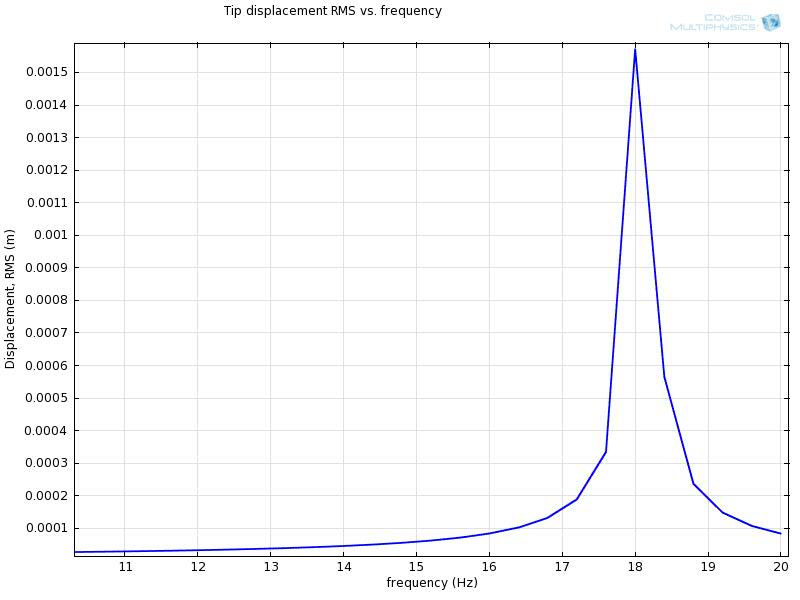

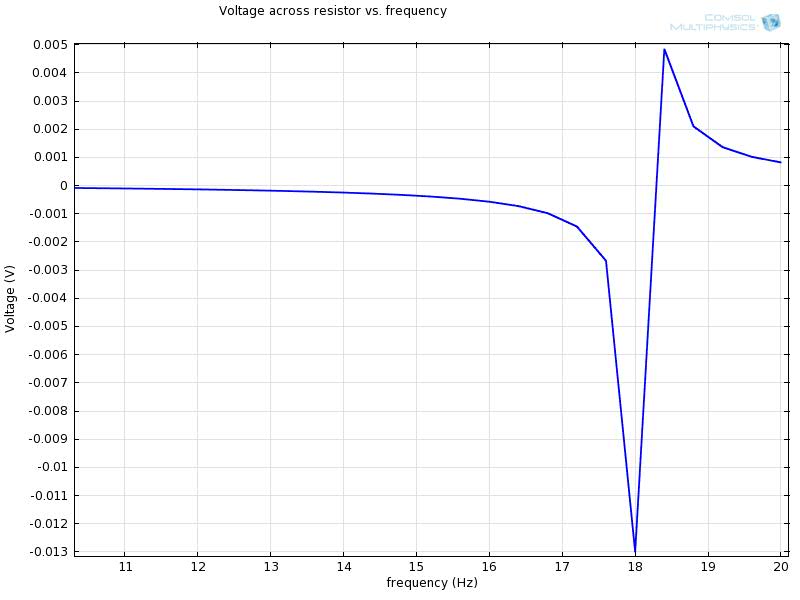

Hi, I am doing the simulation with the cantilever coated by piezo material. When I do the frequency sweep, the cantilever tip displacement and output voltage reach its highest at the resonant frequency. My question is why there is a voltage leap from the negative to positive.
Thank you!
Hi, I am doing the simulation with the cantilever coated by piezo material. When I do the frequency sweep, the cantilever tip displacement and output voltage reach its highest at the resonant frequency. My question is why there is a voltage leap from the negative to positive. Thank you!
Posted: 1 decade ago 27 giu 2012, 10:45 GMT-4
it has probably to do with the phase lag of your signal which inverses, before the resonance you are driving it, after its the resonance that is ahead of your excitation
Difficult to say more without running a full case
Hi it has probably to do with the phase lag of your signal which inverses, before the resonance you are driving it, after its the resonance that is ahead of your excitation Difficult to say more without running a full case -- Good luck Ivar
Posted: 1 decade ago 27 giu 2012, 10:51 GMT-4
It is probably a phase issue as Ivar mentioned. Even without piezo effects, before resonance phase angle between force and displacement is 0 and after resonance it is 180 degrees (there is a gradual transition when there is damping).
Nagi Elabbasi
Veryst Engineering
It is probably a phase issue as Ivar mentioned. Even without piezo effects, before resonance phase angle between force and displacement is 0 and after resonance it is 180 degrees (there is a gradual transition when there is damping). Nagi Elabbasi Veryst Engineering
Posted: 1 decade ago 27 giu 2012, 11:10 GMT-4
indeed for force versus displacement, but if I got it right here it was V out versus force ?
Hi indeed for force versus displacement, but if I got it right here it was V out versus force ? -- Good luck Ivar
Posted: 1 decade ago 27 giu 2012, 11:16 GMT-4
Is it because Force and the induced Voltage are always in the same phase?
Posted: 1 decade ago 27 giu 2012, 13:03 GMT-4
if you have a PZT beam, fixed at one end and loaded by a varying force load at the other end, then the force will introduce a deformation of the beam, hence a stress build-up. This stress buildup will generate charges that will populate the electrodes hence induce an electric field across the PZT, this field will vary if the electrodes are free, or grounded (short) or hooked up to some other intermediate or complex impedance. Now the electric field will act on the stiffness tensor and change the deflection hence the response and off we are with a chicken an the egg story: who came first ?
So I would say your foce induces a flexing whcih nitroduces a stress change with induces a potential. But you can loop the other way too ;)
Normally you can simulate the eigenfrequency change if your electrodes are shorted or pen loop, the difference in frequency gives yout the elecric to mechani coupling factor "k"
As you have losses in the PZT and perhaps in the driving circuit of your PZT you will get complex responses so you mst study the behaviour with Bode plots for the amplitude "abs(...)" and the phase "atan2(imag(...),real(...))"
Hi if you have a PZT beam, fixed at one end and loaded by a varying force load at the other end, then the force will introduce a deformation of the beam, hence a stress build-up. This stress buildup will generate charges that will populate the electrodes hence induce an electric field across the PZT, this field will vary if the electrodes are free, or grounded (short) or hooked up to some other intermediate or complex impedance. Now the electric field will act on the stiffness tensor and change the deflection hence the response and off we are with a chicken an the egg story: who came first ? So I would say your foce induces a flexing whcih nitroduces a stress change with induces a potential. But you can loop the other way too ;) Normally you can simulate the eigenfrequency change if your electrodes are shorted or pen loop, the difference in frequency gives yout the elecric to mechani coupling factor "k" As you have losses in the PZT and perhaps in the driving circuit of your PZT you will get complex responses so you mst study the behaviour with Bode plots for the amplitude "abs(...)" and the phase "atan2(imag(...),real(...))" -- Good luck Ivar

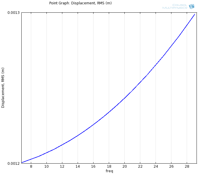

Posted: 1 decade ago 21 lug 2012, 20:44 GMT-4
I've tried applying 'prescribed acceleration' to the fixed end of the beam and managed to get the 'voltage vs freq' plot. However, when i do analysis of the beam's deformation at every single frequency, I've found out that the fixed end of the beam moves. It stays fixed only at the natural frequencies. I believe this might be due to 'fixed constraint' is overridden by 'prescribed acceleration'. If 'fixed constraint' overrides 'prescribed acceleration', there will be no output voltage generated.
If I changed the 'prescribed acceleration' to 'body load' of "pzd.rho*acceleration", the fixed end stays fixed throughout the simulation. However, I noticed that the list of eigenfrequencies changed and I'm not sure why.
If I want to plot the voltage distribution at every point accross the length of the beam, should i choose "electric field-Z component"?
Hi, I've tried applying 'prescribed acceleration' to the fixed end of the beam and managed to get the 'voltage vs freq' plot. However, when i do analysis of the beam's deformation at every single frequency, I've found out that the fixed end of the beam moves. It stays fixed only at the natural frequencies. I believe this might be due to 'fixed constraint' is overridden by 'prescribed acceleration'. If 'fixed constraint' overrides 'prescribed acceleration', there will be no output voltage generated. If I changed the 'prescribed acceleration' to 'body load' of "pzd.rho*acceleration", the fixed end stays fixed throughout the simulation. However, I noticed that the list of eigenfrequencies changed and I'm not sure why. If I want to plot the voltage distribution at every point accross the length of the beam, should i choose "electric field-Z component"? Thanks
Posted: 1 decade ago 22 lug 2012, 03:06 GMT-4
indeed if you apply a prscribed acceleration, your object CANNOT be fixed these are antogonists. What you can do is to apply a body load of the type "material.rho*my_acceleration" and keep the fixed section "fixed".
I'm neither not fully happy as today I have not found a clean way to apply a shaker type PSD on a model, in a simple way. there are several threads about this on the Forum, try a search
Hi indeed if you apply a prscribed acceleration, your object CANNOT be fixed these are antogonists. What you can do is to apply a body load of the type "material.rho*my_acceleration" and keep the fixed section "fixed". I'm neither not fully happy as today I have not found a clean way to apply a shaker type PSD on a model, in a simple way. there are several threads about this on the Forum, try a search -- Good luck Ivar
Posted: 1 decade ago 1 ago 2012, 00:04 GMT-4
Hi Ivar,
From the attached figure, does my model represent a beam subjected to base excitation? (the beam is attached to a big rigid mass). I've applied body load before to the rigid mass but the output voltage generated is maximum at the fifth eigenfreq. If I changed it to prescribed acceleration and applied it on top of the rigid mass, I can see that the maximum value of voltage is at the first eigenfreq (which is theoretically correct according to my understanding)
thanks
Hi Ivar, From the attached figure, does my model represent a beam subjected to base excitation? (the beam is attached to a big rigid mass). I've applied body load before to the rigid mass but the output voltage generated is maximum at the fifth eigenfreq. If I changed it to prescribed acceleration and applied it on top of the rigid mass, I can see that the maximum value of voltage is at the first eigenfreq (which is theoretically correct according to my understanding) thanks
Posted: 1 decade ago 1 ago 2012, 00:43 GMT-4
However, by applying prescribed acceleration, the value of voltage is hundreds volts, which is I think is not correct
Posted: 1 decade ago 2 ago 2012, 14:29 GMT-4
from you image, you should not use fixed and acceleration simulatneously, but you must use two roller conditions on two opposite sides of your sqare mass at right angle to the acceleration direction. Be sure you large mass is "large" compared to the beam, and then get the correct estimate of the true load on the beam
100V is not necessarily that much, you can get a sparck (>1kV) easily with a stressed PZT, but this also depends strongly on the impedance you connect up on your PZT
Hi from you image, you should not use fixed and acceleration simulatneously, but you must use two roller conditions on two opposite sides of your sqare mass at right angle to the acceleration direction. Be sure you large mass is "large" compared to the beam, and then get the correct estimate of the true load on the beam 100V is not necessarily that much, you can get a sparck (>1kV) easily with a stressed PZT, but this also depends strongly on the impedance you connect up on your PZT -- Good luck Ivar
Posted: 1 decade ago 3 ago 2012, 01:37 GMT-4
I think I'd better stick with your initial suggestion that is to apply body load. I use steel as the large mass due to its stiffness and aluminum beam. I apply fixed constraint to the faces of the mass except for the one that is attached to the beam.
I'm currently using one physics only that is piezoelectric device. I apply floating potential to the top of the PZT and ground at the bottom of the layer and this is how I extract the voltage generated Do I need to add another physics(i.e electrical circuit) for the impedance?
Hi I think I'd better stick with your initial suggestion that is to apply body load. I use steel as the large mass due to its stiffness and aluminum beam. I apply fixed constraint to the faces of the mass except for the one that is attached to the beam. I'm currently using one physics only that is piezoelectric device. I apply floating potential to the top of the PZT and ground at the bottom of the layer and this is how I extract the voltage generated Do I need to add another physics(i.e electrical circuit) for the impedance? Thanks
Posted: 1 decade ago 3 ago 2012, 04:41 GMT-4
indeed fixing your block and applying a body load as an acceleration is o good way, in a frequency domain sweep you can get the frequency response too of your system. If you leave a floating potential its as if you have an open circuit, you voltage will be given by the charge build-up and the PZT beam capacity. If you add a CIR physics with an electric impedance of some kind, i.e. representing the entry impedance of your system, then you will see the response and voltage build up of your device in loaded conditions. One way to optimise the energy transfer is to play with the bandpass of your load impedance and the response of the beam
Hi indeed fixing your block and applying a body load as an acceleration is o good way, in a frequency domain sweep you can get the frequency response too of your system. If you leave a floating potential its as if you have an open circuit, you voltage will be given by the charge build-up and the PZT beam capacity. If you add a CIR physics with an electric impedance of some kind, i.e. representing the entry impedance of your system, then you will see the response and voltage build up of your device in loaded conditions. One way to optimise the energy transfer is to play with the bandpass of your load impedance and the response of the beam -- Good luck Ivar
Posted: 1 decade ago 3 ago 2012, 12:33 GMT-4
Thanks a lot. you've been really helpful
Hi Thanks a lot. you've been really helpful

Posted: 1 decade ago 11 dic 2012, 22:32 GMT-5
I've applied body load to represent base excitation, and assigned "added mass" BC at the free end of the cantilever ( to represent tip mass). Howver, it shows that the voltage output at the eigenfreq keeps decreasing as the "added mass" increases. I believe by adding the tip mass, the voltage will be increased.
Hi, I've applied body load to represent base excitation, and assigned "added mass" BC at the free end of the cantilever ( to represent tip mass). Howver, it shows that the voltage output at the eigenfreq keeps decreasing as the "added mass" increases. I believe by adding the tip mass, the voltage will be increased. Thanks
Posted: 1 decade ago 12 dic 2012, 01:33 GMT-5
if you add an "added mass then you must also add a boundary force, as the body load applies ONLY forces to the DOMAIN, not to the added mass that is a separate "fictuous " entitiy do not forget that ;)
Hi if you add an "added mass then you must also add a boundary force, as the body load applies ONLY forces to the DOMAIN, not to the added mass that is a separate "fictuous " entitiy do not forget that ;) -- Good luck Ivar
Posted: 1 decade ago 12 dic 2012, 23:45 GMT-5
The added mass reduces the natural frequency so the voltage may be dropping because the frequency you specified in the frequency domain analysis is no longer close to the beam’s natural frequency.
Posted: 1 decade ago 13 dic 2012, 00:18 GMT-5
thanks for the reply. in the frequency analysis, I've specified a range of frequency, the eigenfrequency lies within that range.
Thanks.
Hi, thanks for the reply. in the frequency analysis, I've specified a range of frequency, the eigenfrequency lies within that range. Thanks.
Posted: 1 decade ago 13 dic 2012, 12:03 GMT-5
Ok, one more thing to check. Conceptually, if you apply a certain body load and you change the structure by adding mass the deformations should in general be lower and also the voltage.
Posted: 1 decade ago 13 dic 2012, 12:59 GMT-5
Hmm,may I know why? Because from what I understand, Adding tip mass to the structure increases the strain,which eventually increases the deformation. Body load is assigned on the "large" mass attached to the beam and added mass is assigned at the other end of the beam,together with boudary load
Hmm,may I know why? Because from what I understand, Adding tip mass to the structure increases the strain,which eventually increases the deformation. Body load is assigned on the "large" mass attached to the beam and added mass is assigned at the other end of the beam,together with boudary load Thanks
